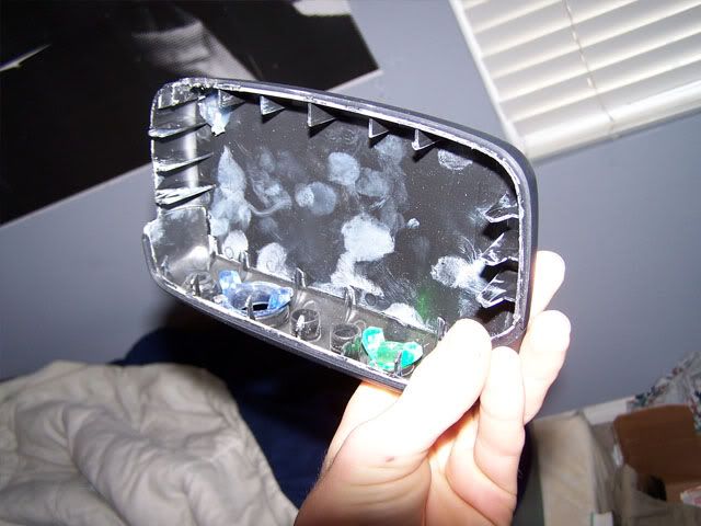

    So, I opened up the control unit. It was superglued together, not sure if thats normal or not. Anyways, inside I found tons of some sort of white powdery stuff and other traces of superglue. I can tell that this isn't something fungal or whatever because somebody's fingerprints of this stuff is all over the inside.

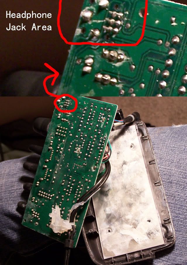

    So I took the board off of its little resting plate, and the headphone jack works fine, fully functional now as it should be. The only thing is, the regular audio system is still not working.

    If you mean the white stains on the green pcb laquer, could be somebody's tried cleaning it with something stronger than IPA.

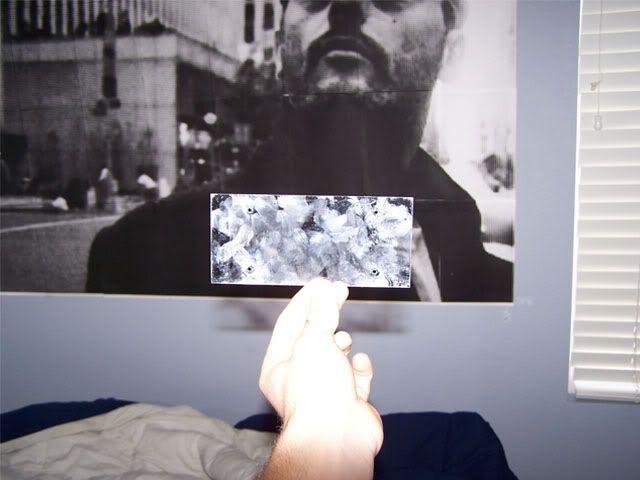

    more pictures hopefully explain. Is it more likely a problem with my control box/wiring or do you think somehow the amp actually did go out?
    Top cover of control box
    Plastic sheet over the grounded metal area

    Could be superglue? It tends to leave that sort of mess. If it was refurbished, someone could have used it for repairs.

    I think you're right Fishcake.He said there were traces of superglue and (see it on tv)the police use the fumes from the glue to show up fingerprints and they look like that.

    The white powder comes from the flux used in the wave soldering process of the PCB assembly. By right, the board should have been cleaned after the process. Looks like the cleaning was not done properly and the white powder is a result of temperature / humidity changes. You maybe able to clean it using IPA. Please wash your hands properly if you touched it.

    It's the superglue, in confined spaces the vapor given off sticks to any source of moisture it can find, fingerprints being one of them.
    Add: The stains on the case (the only pictures I could see when I wrote my first reply) are definately superglue, the stains on the PCB could be either flux from the original soldering, superglue, or also fairly likely flux/pcb coating which has been melted/vaporised during the re-work process.
