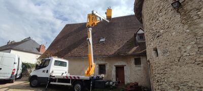

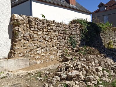

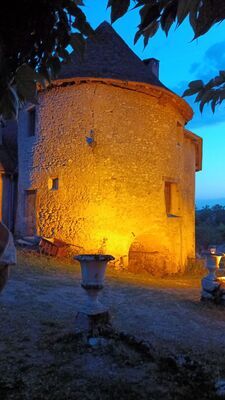

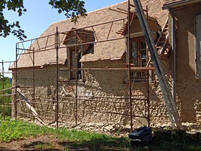

    Hi guys, well, I reckon that I am not haunting BT forums anymore for a while, I am busy with the sell of my house, large renovations were necessary to get a nice price, wich implies parts of the perimeter walls, roofs and facades, so all my projects are stopped until the sale...BTW, if someone is interested by an ancient house with almost 2.5 acres of land in France, PM me :grin:
