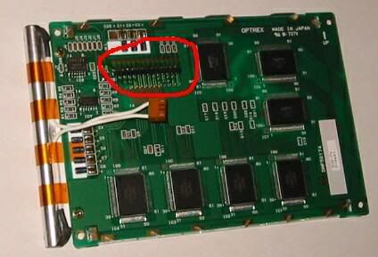

    reading a recent thread i got re-directed to www.lcdgallery.net, so now that I’ve got to looking around(and planning a future mod) i have decided i want to try and wire one of these babys up :thumb: . the one i think i want to go for is the this Stanley , what is it gona take for me to wire this up ?? Am I gona need a controller, I’m new to these kind of LCDs and would appreciate some help :thumb: especially from the LCD god coorz :rock:

    That display has a S1D13305F controller, according to the datasheet. You can directly connect that to your parallel port.

    when you talk about the FFC connector is that whats circled in red ? if not, what am i looking at cause i'll ask for some better pics.

    The FFC connections are those 14 copper traces starting from under that CCFL connector in the red circle, normally there'd be a FFC cable soldered and glued to it.
    The row above it looks like normal 2.54mm pitch pads but i can't see proper.

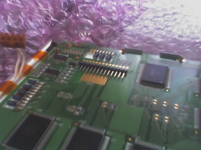

    well it arrived today and found a great surprise, its got little headers !! [​IMG]
    wich is going to help hook it up much easier. but now i need some help on the wirring part :D so as i await for a reply, i shall go bondo !!!

    before i place an order for the controller, do i need an inverter for the backlight ?? i thought i did when i went over the data sheet, but i wana make sure.

    Yes, you'll need an inverter. Be sure to match the bulb to the inverter.

    so if im reading this correctly i need one thats 220 V and 5 ma ?? right ? i just wana be sure, so i dont blow anything up :D

    Try Crystalfontz, they sell a suitable one for 320x240 sized LCD's.
