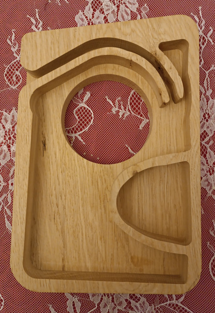

    Et voila. Just a couple of bits of oak I glued together. They were quite warped, so by the time I'd flattened and glued them together, the total thickness was only 50.5mm, so this test piece is about 1.5mm too thin, but for the purpose of the test, it's fine. For the same reason, I haven't drilled the dowel holes or recessed the outside face for the speaker. Ignore the knots.
    The tweeter hole will need to be cut with a handheld router once two halves are clamped together. I'm working on a template to make it easy for me.
    How are you planning to hold the two halves together? Dowels work for alignment, but they don't pull the two halves together.
    I see the two metal plates in the 3d model. Do you want me to cnc those out of aluminium for you?

    oh my that is sweet, and yeah dowels for alignment and was thinking of gluing with plenty of clamps until dry, as for the plates if it no trouble then yes that would be great.
