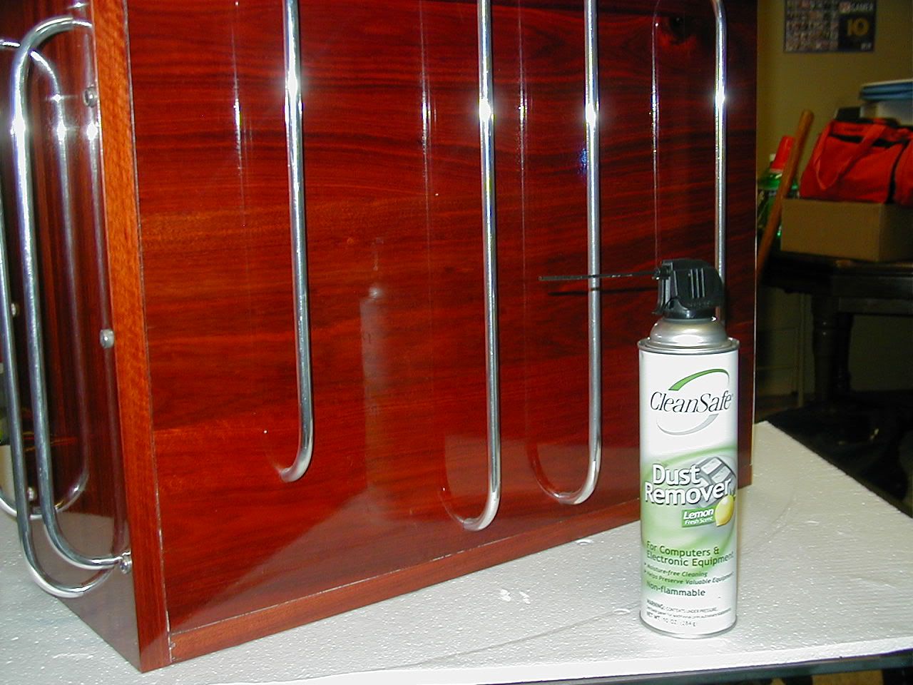

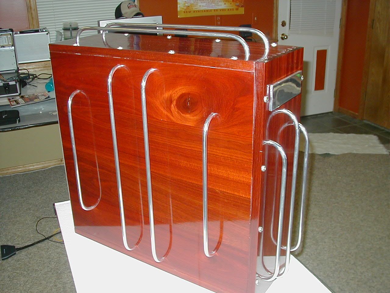

    A buddy of mine Dylan Wammack had the idea about 4 years ago to make an all WOOD case! Well I was the only person to take him seriously and decided to put this idea to work! Well it took about a week and half for me to convince him that it is entirely possible and to get him to make one with me! Well it worked so therefore we started looking for the wood we wanted to use so I pointed out a wood that i had been admiring forever due to its beautiful DEEP RED color! Bloodwood! This was a mistake that i would soon forget about after it was done! This wood is OILY! When cut with any sort of blade it slowly builds up and gunks the blade (it smells like chocolate though), kinda like the same effect aluminum has on carbide blades! And sanding is pretty much impossible unless using a grit like 60-80. The grit was really course but the wood clogged up the paper and at the same time polished the wood as I sanded it, worked out better than I thought it would! So i learned to be patient and I finally finished it! Dylan on the other hand gave up on the case after finiding a deal on a LIAN LI PC 70 with 8 Tornadoes preinstalled and pre Bay-Bus'd for $200 Dollars! So now I have one finished Computer and one that will be entering the Project logs soon! Well for the past 3-1/2 years I have been modding, gaming, lanning, schooling, working but mostly trying to finish my MACHINE! Well it is done! $550 in Bloodwood + koolance WCing + P4 + X800 Pro AGP + Gigabyte 8TRS350MT Ati Chipset + 4 x 256 Mb PDP Extreme PC3200 + Ultra X-Connect + 3 Tornadoes 92 MM =

    Hmmm... Well the alumium is quite strong due to the fact that it is angle iron, but i just went up to Lowes, Homedepot, and a local Farm Supply called MFA to get it so it is nothing to fancy (Basic Arch Angle). You can actually see the barcode tag on the front view of it (by the hardrive)!
    Something i would like to do different is instead of using rivets (2-3 in every joint then Hammer Set) i would have rather drilled and countersunk 1/8" socket head bolts! I ran out of time and had to throw the frame together at the last minute (I still have the bolts though ready to go so i might make a Good backup Frame)! It Fits. It Works, and it is sturdy as hell so it is good to go!
    Also you see the Mo/Bo mounting plate i would have rather SHEETHED the entire back with aluminum rather than just part but that is all i had in my store room so... Also i would have rather of covered the rest of it in PLEXI but yet again time got me!
    Thanks for your comments and taking a look at my Built from scratch computer!
