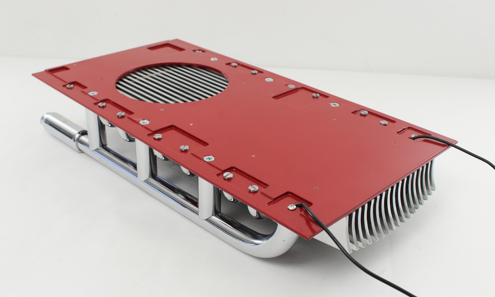

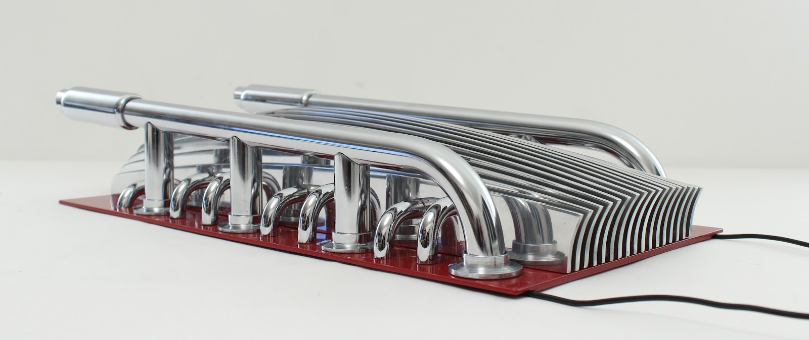

    3D animated assembly of the upper part of the case
    Laser cutting. 4 mm aluminium
    Rib grinding
    After polishing

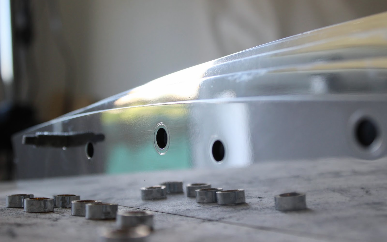

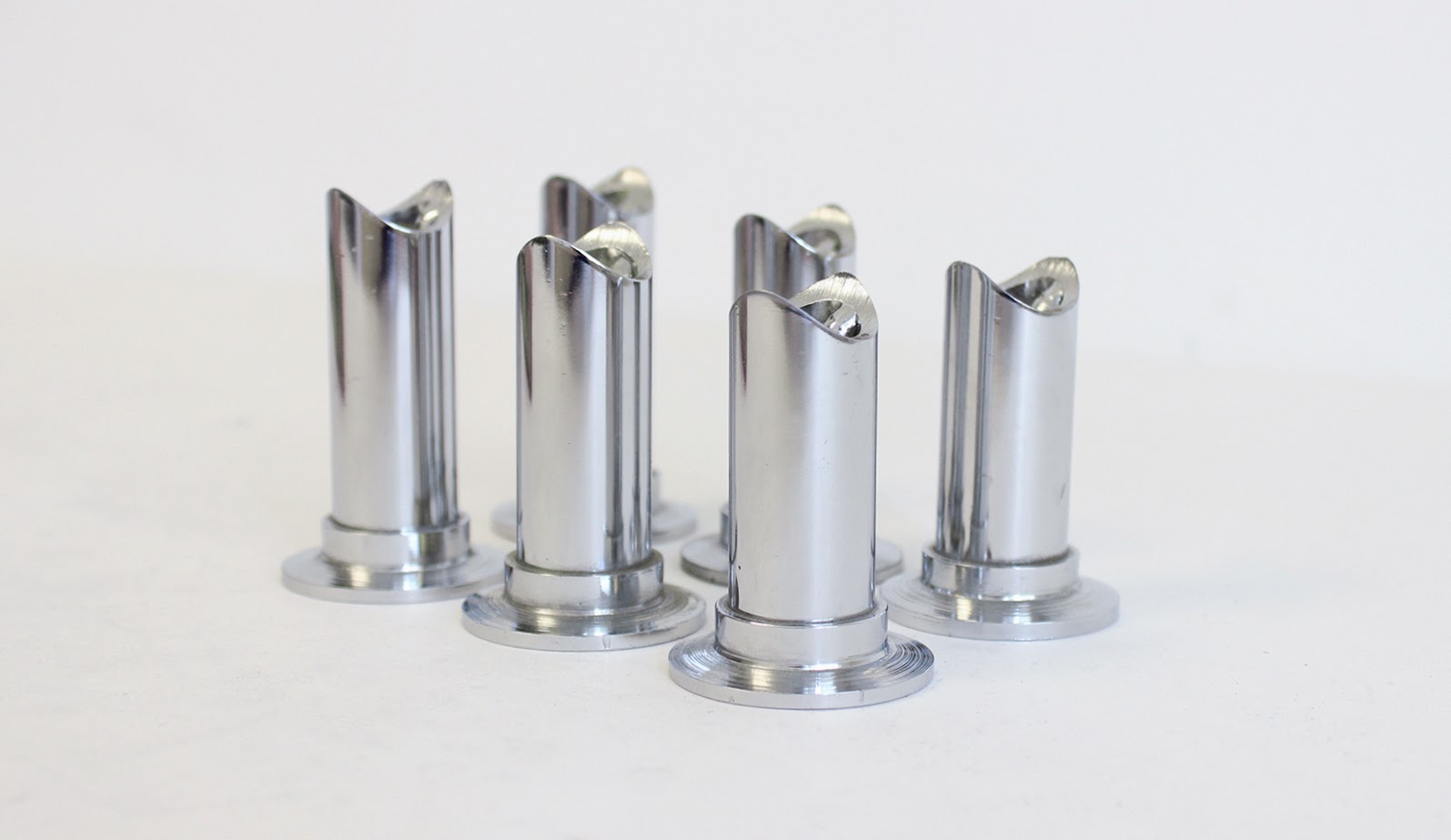

    112 bushings cut on a lathe from 12 mm chrome-plated brass pipe

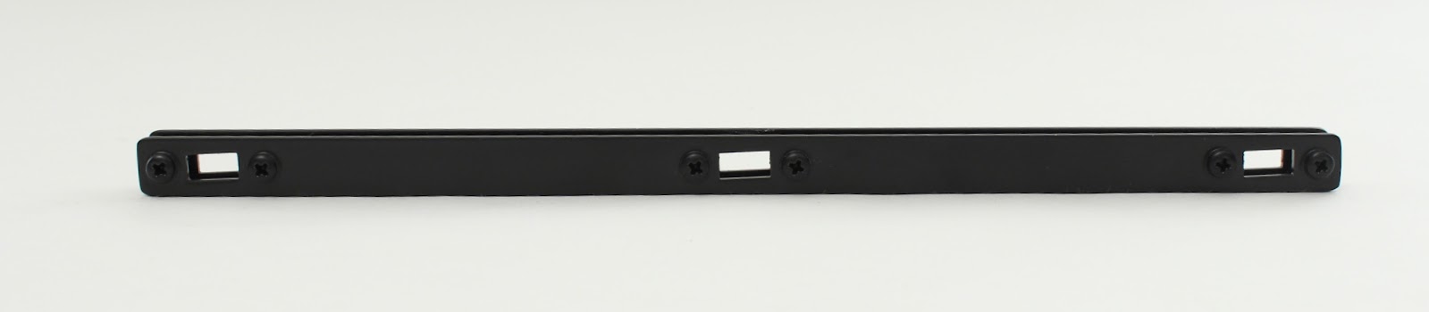

    Angle steel bars, 12 mm, chrome-plated

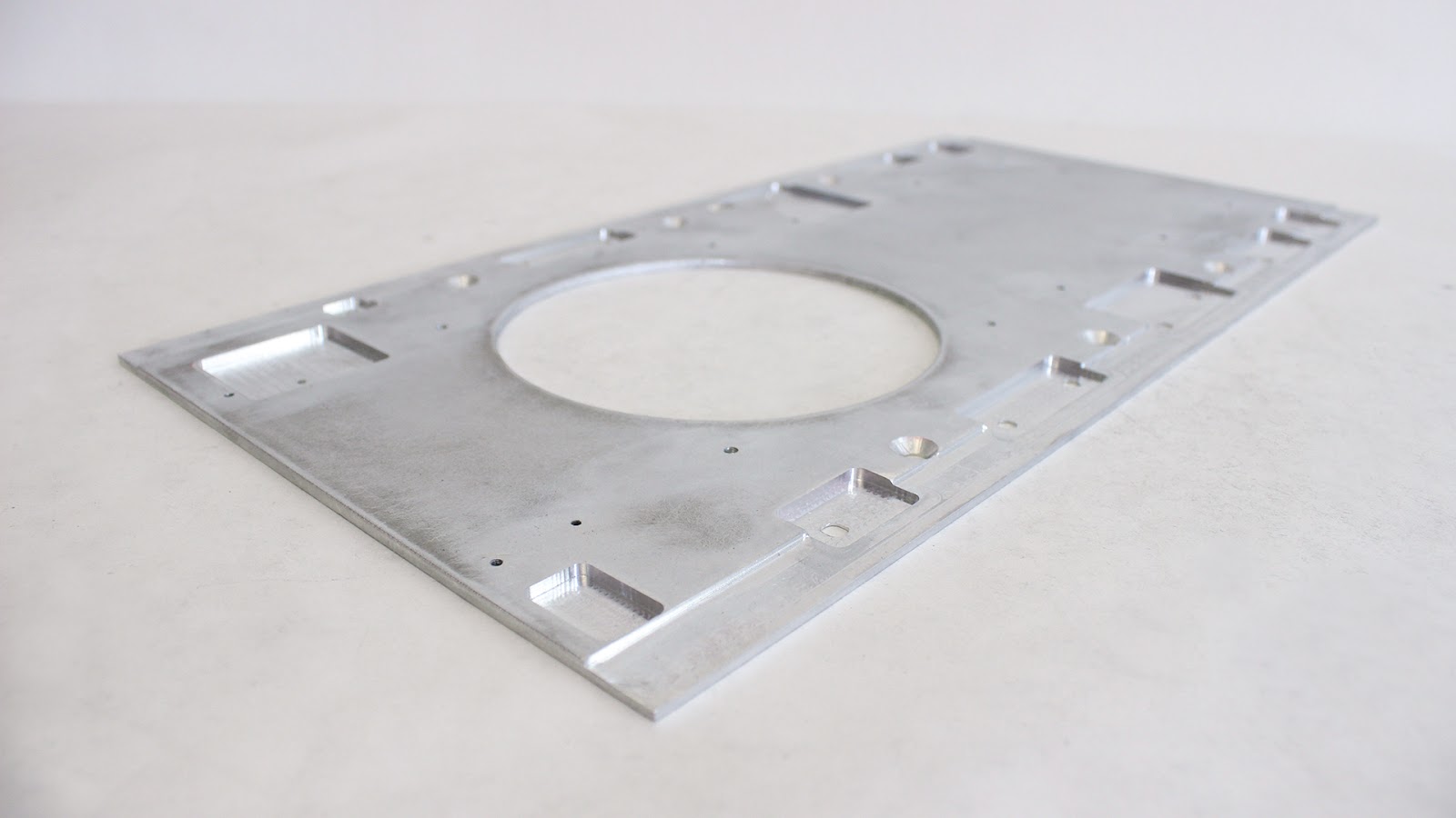

    Laser cutting, milling. 4 mm aluminium
    Powder coating, RAL 3011
    On its place
    Screwing up by flat-head M5 screws. Heads are additionally grinded off

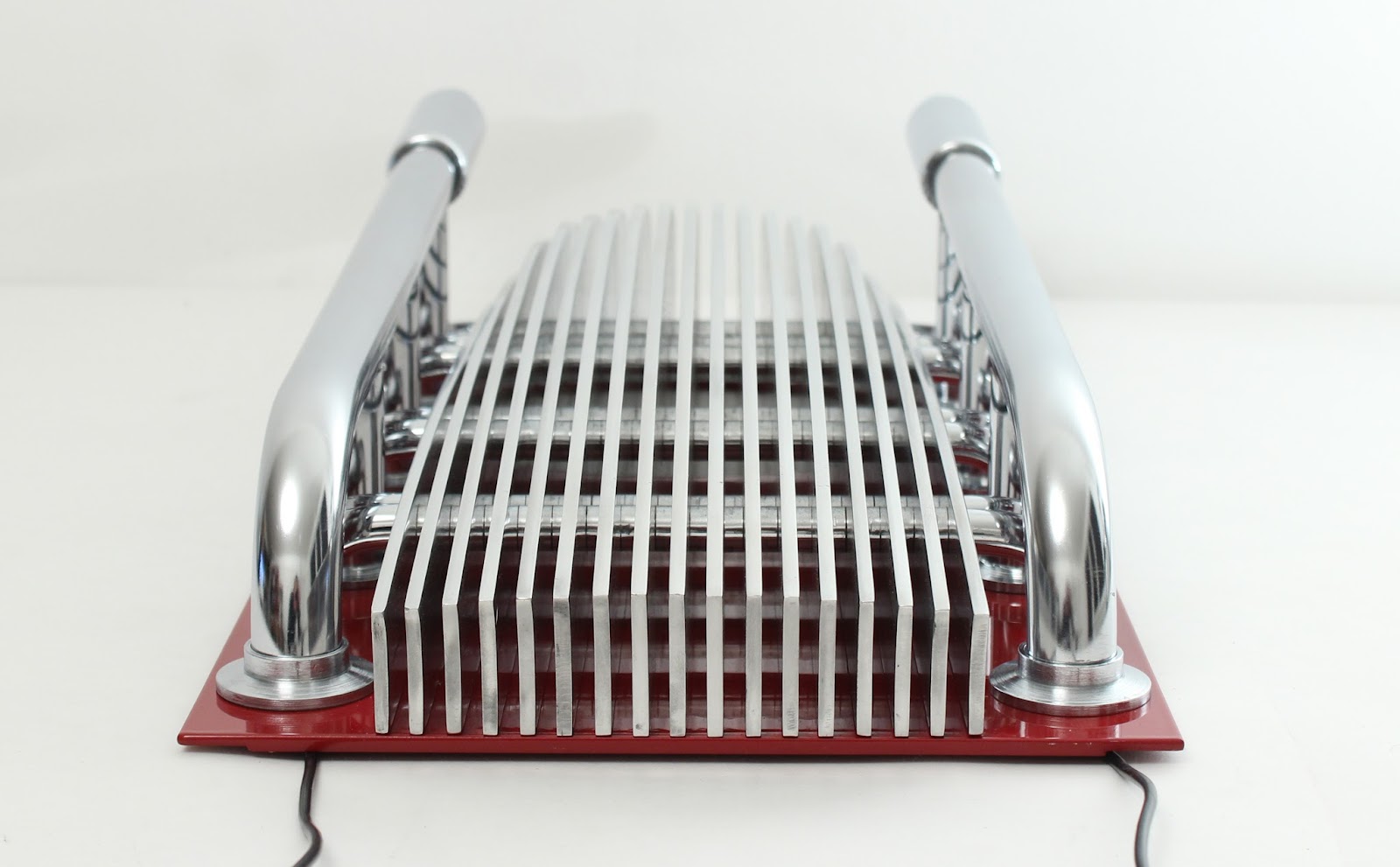

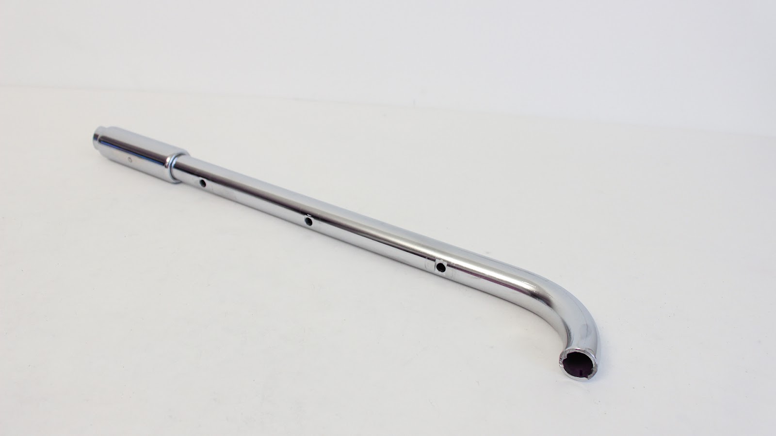

    High-pressure 22 mm water pipe, 2.5 mm thick. Turning, welding, chrome-plating
    On its place
    The same high-pressure pipe, bent and chrome-plated. On the tail there is a muffler model

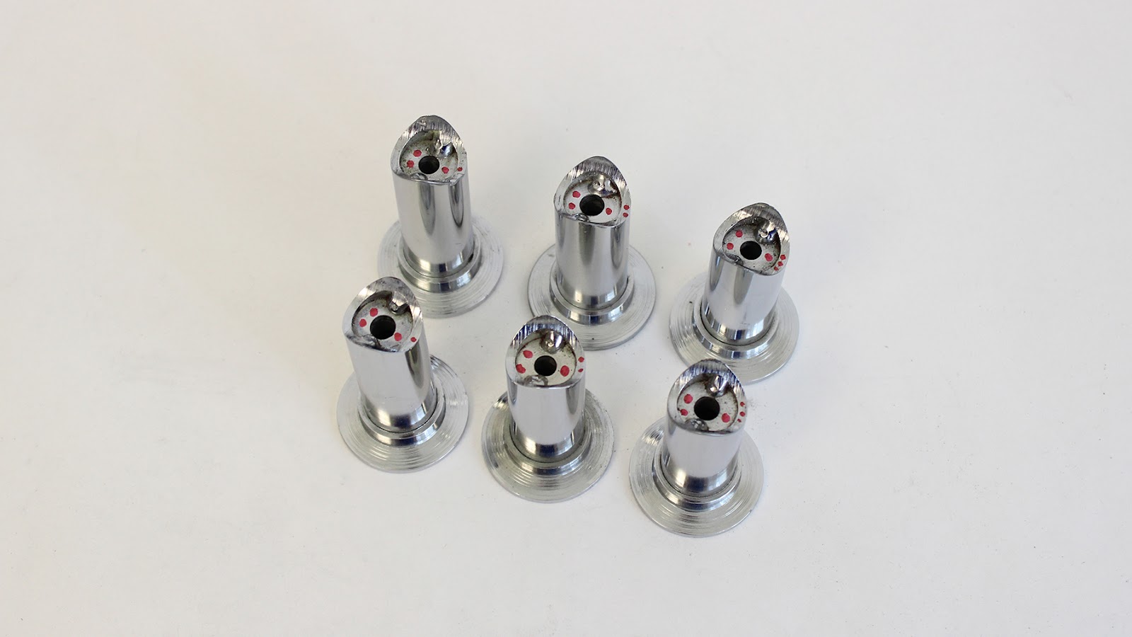

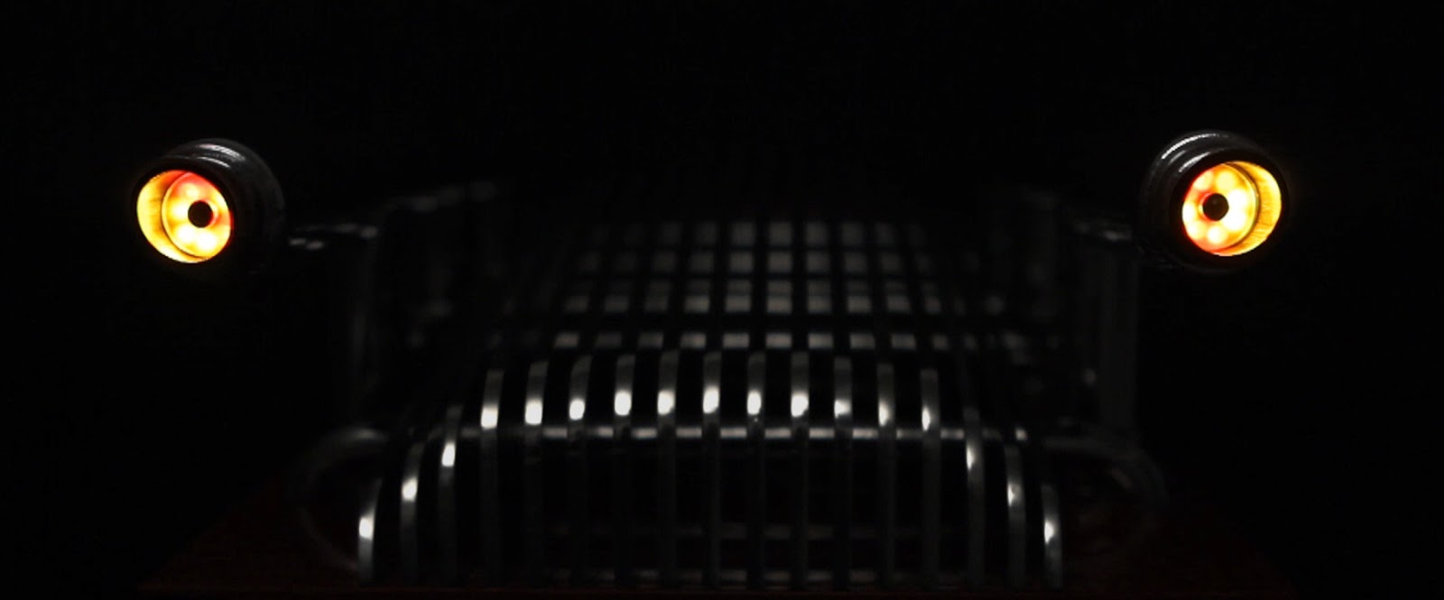

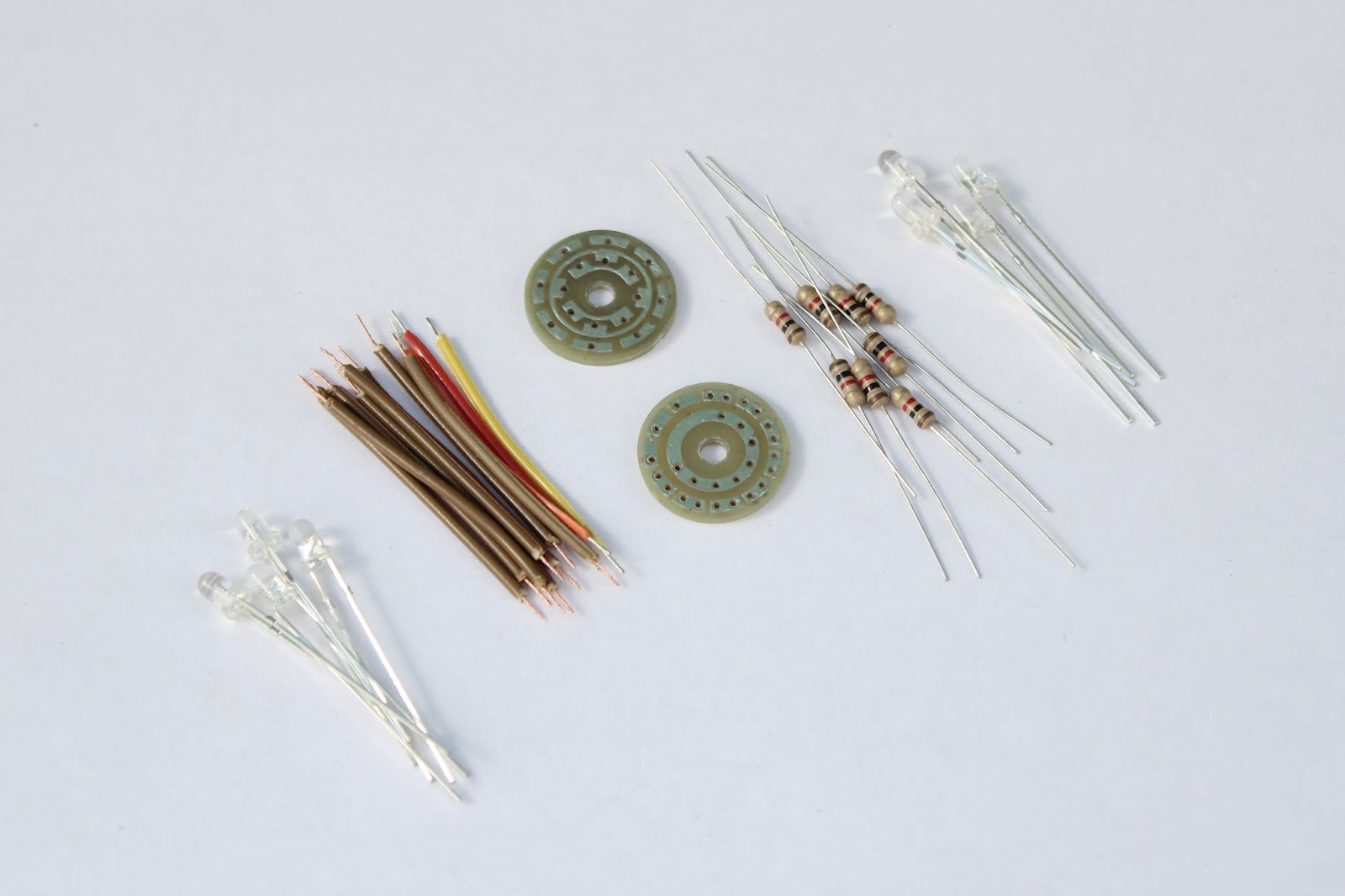

    Components of a "flame simulator" for pipes
    3 channels, consisting of red and orange LEDs. Controlled by driver: the first channel is always on, second and third channels generate random brightness from 0 to 100% 20-25 times per second
    The diameter of the device is 17 mm
    It is held in the pipe by the tension of the cable. It doesn't go deeper because of the prominent screw in the pipe

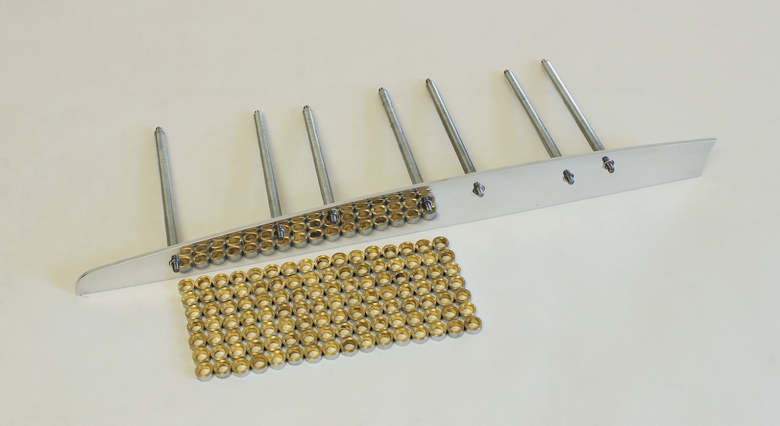

    Device for holding nuts right angle inside the pipe
    Laser cutting, 2 mm steel. Nickel-coated brass standoffs are used as separators
    After the powder coating
    Square nuts DIN 562 M10. Before they will be connected with screws, they are prevented from falling out by foil glued to the sides
    Nut-holder position in the pipe
    Assembly
    The nuts are on their places
    The pipes are ready to install
    The structure assembled, simulates a grille of a vehicle and exhaust pipes with silencers
    "Flame simulator" working
    The rear view on the structure suddenly turned out to be very impressive :D
    Booo

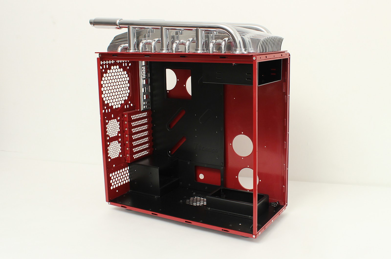

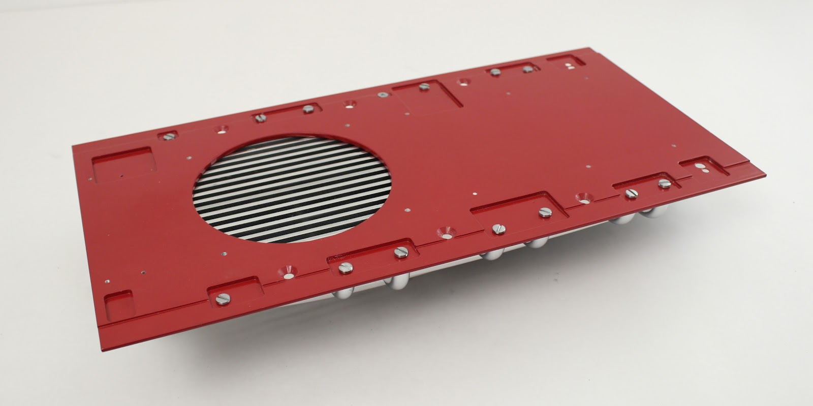

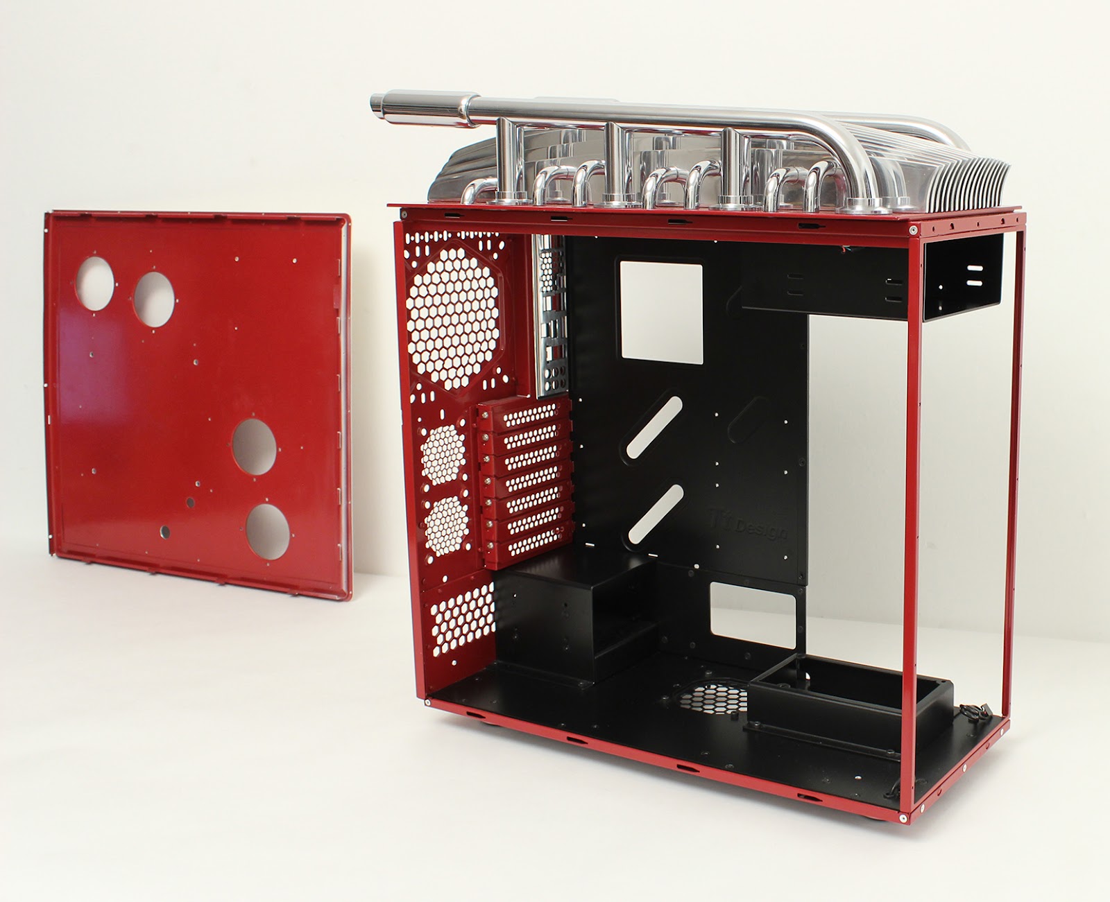

    The top is ready and now we have to connect it with the chassis
    The chassis upside down
    Optical drive enclosure. Laser cutting, CNC bending. 2 mm aluminum
    It is screwed by M3 screws to 4 mm top plate, thereby connecting it with the chassis
    Illumination fastens are ready for devices

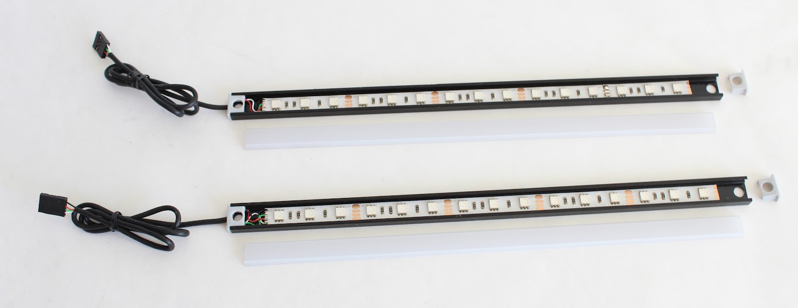

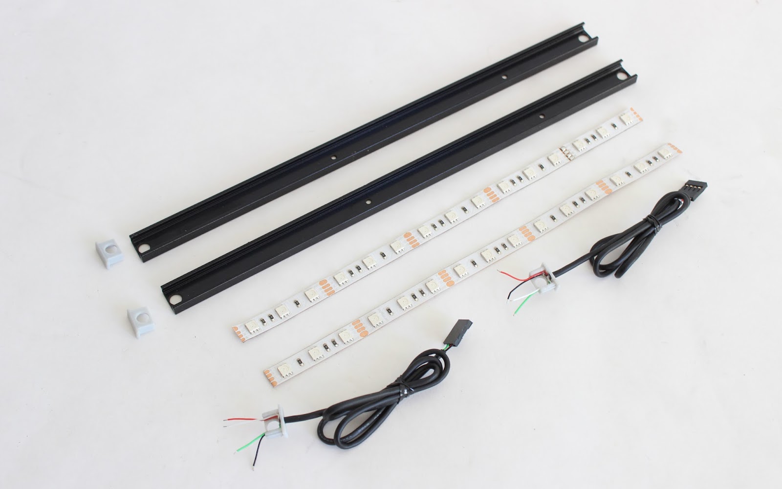

    RGB LED stripe for inner illumination
    The same 6 mm profile for LED stripe that is used in the bottom of the case. With a light-diffusing screen
    Assembled
    Illumination is installed. 4 screws, in addition to those already installed in the enclosure, connect the top structure with the chassis
    General view

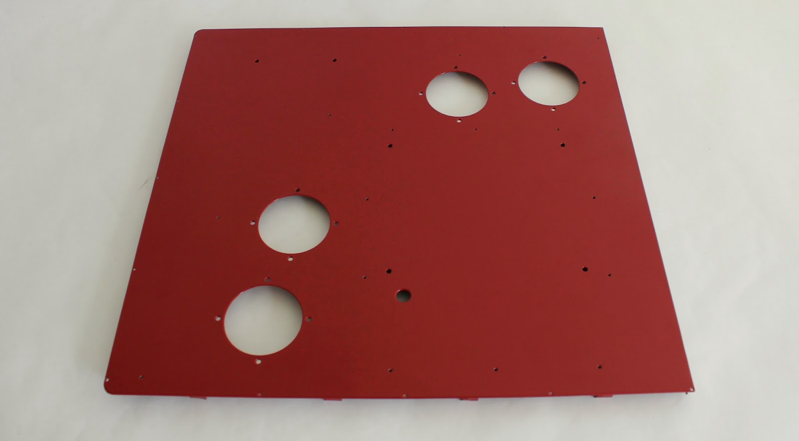

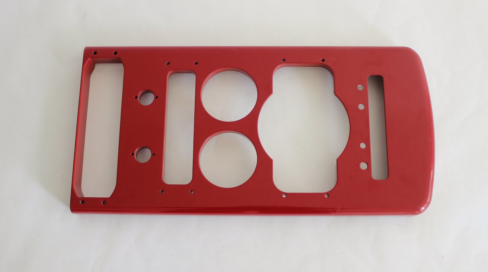

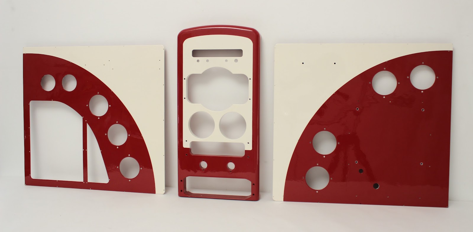

    Front panel, finish sanding before painting
    General view of the mounting holes
    Four threaded blind M2 holes for fastening the button "eject the tray"
    Threaded blind M4 holes and through M6 holes
    The front panel
    The right panel
    The left panel
    The left panel. Powder coating, RAL 3011
    The right panel. Powder coating, RAL 3011
    The front panel. Powder coating, RAL 3011

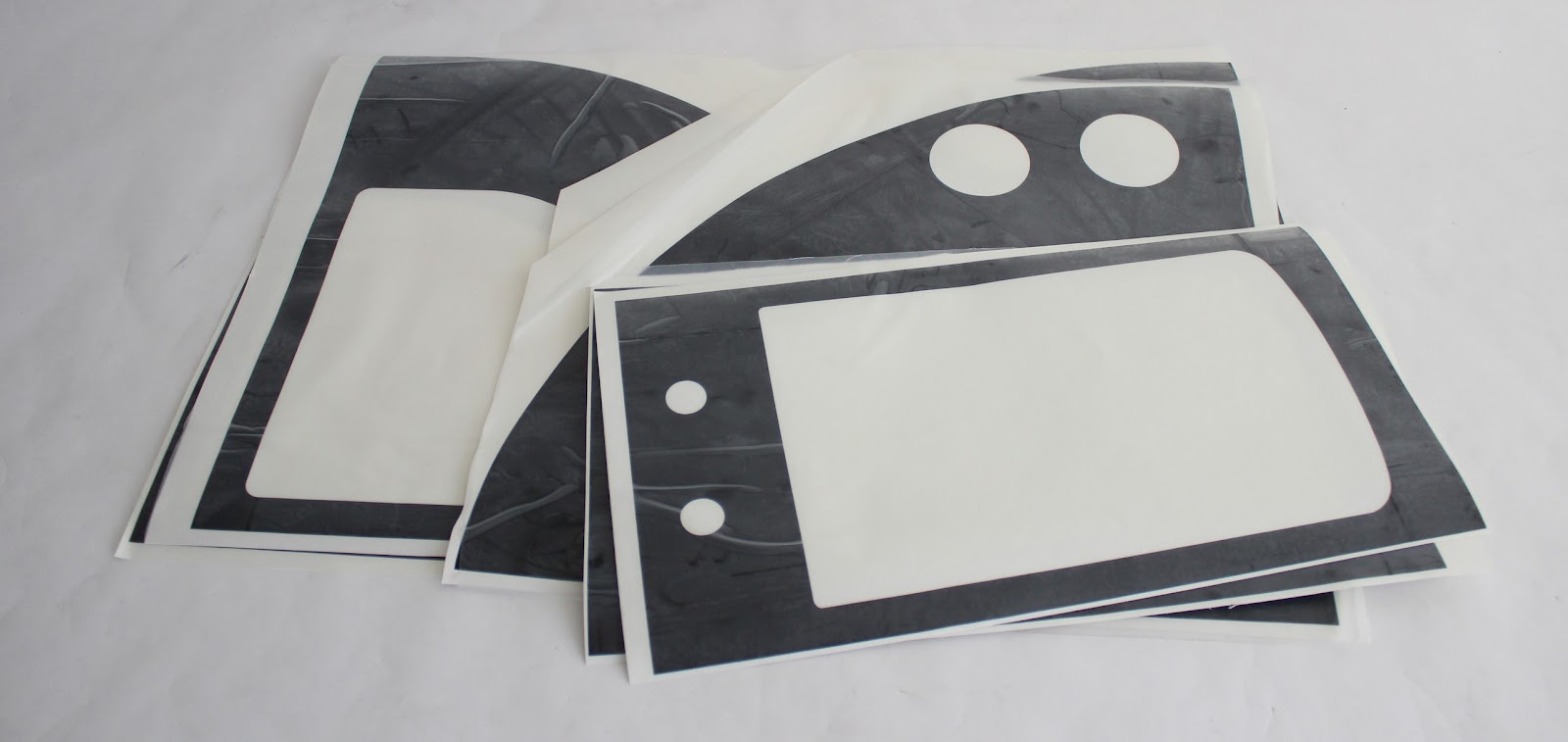

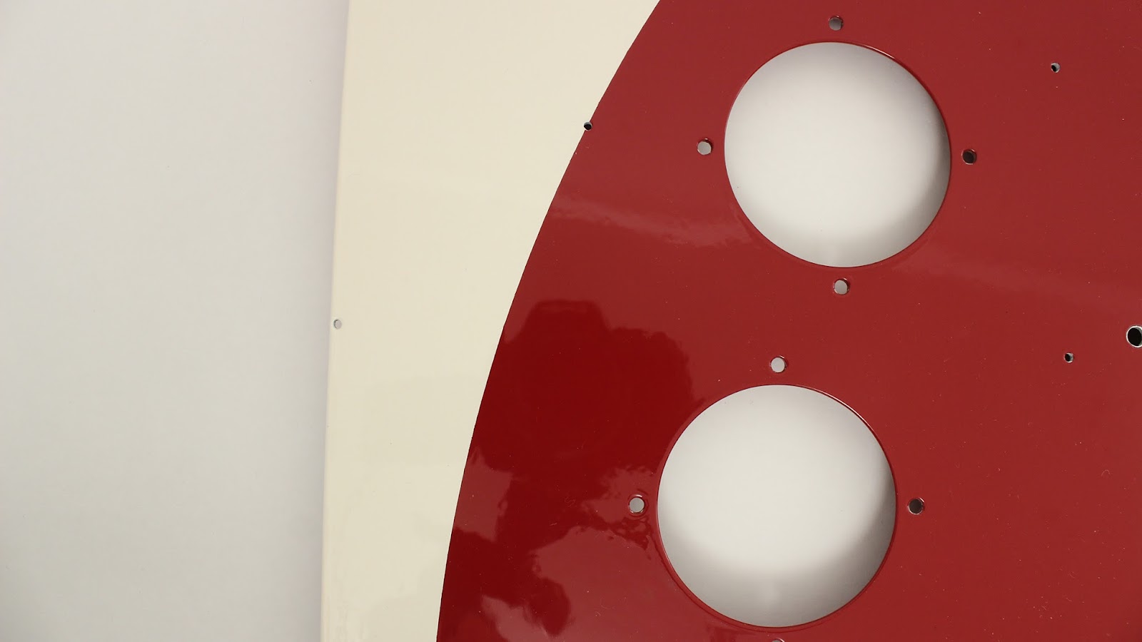

    Stencils for second color painting. Plotter cutting, self-adhesive film Oracal 641
    Stencils for each part in duplicates :)
    Stencil for the left panel
    Excluding the unnecessary elements
    All the stencils are covered with special adhesive film
    The second layer of paint was applied in the paint shop. It was Dupont car enamel, covered with varnish
    The right panel
    The left panel
    The front panel
    Fitting the panels
    The painting was inspired by the coloring of the 50's cars.
    On the photo "Buick 1955"
