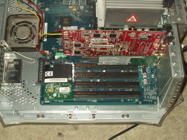

    My PowerMac has PCI-X slots (I think):
    Theres a bog-standard PCI Wireless card in it, and it works ;)

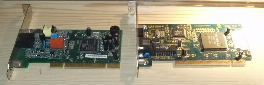

  17. Sam0r
    Sam0r It's been a while
    24 Jun 2005
    1,900
    Left would work in pretty much any PCI/PCI-X Slot
    Right would only work in all PCI slots and a few PCI-X Slots.
