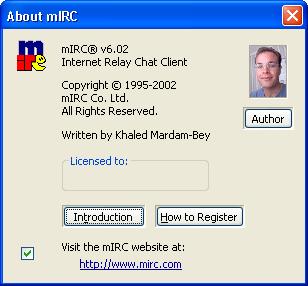

    Just install it the same way as most other apps. When you first run mIRC you will get a box like this::
    Un tick the box then close the window.

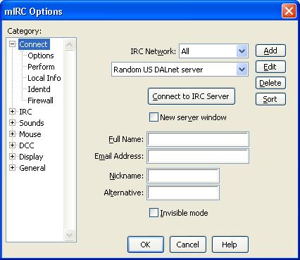

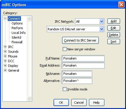

    Then you get this::

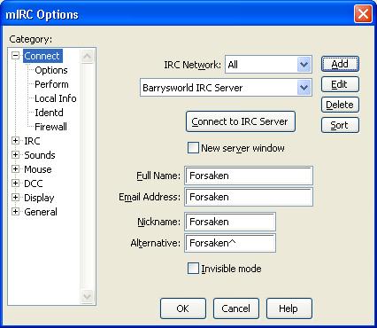

    Enter your name (use you Nick if you are funny about giving out your name), and email address. Now enter the nickname you want to have in the Nickname box, and a second one just incase the first is allready taken in the alternative box.
    Next we need to choose a server to connect to. Click the add button at the top.
    We get this loverly little box up::
    Now we need to pick a server from this list.
    Try to choose one local to you, not that it matters, just helps the speed of things. Give it a name you can rember in the description box, and type its address in the "IRC Server" box.
    Hit add.
    Should be back to this screen now, with the server you just set in the second drop down menu.

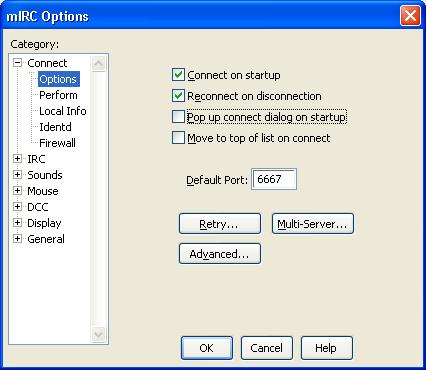

    Next expand the connect part on the options menu on the left, then pick options. tick the "connect on start up" and "reconnect on disconnection" boxes.
    untick the "popup connect dialog on startup" box.
    Click back on connect.

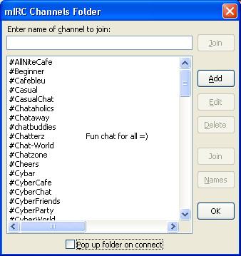

    Hit "Connect to IRC Server", and wait untill it has finished logging you on to the server. After a while you will get this box.
    Untick "pop up folder on connect"

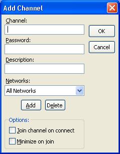

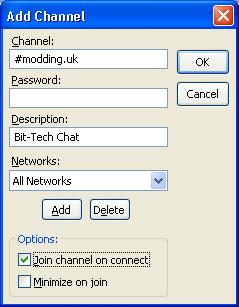

    Click add again. You will get this window
    In the channel box type #bit-tech
    Leave the password box blank
    Type "Bit-Tech Chat" in the description box
    Tick "Join channel on connect"
    Hit ok, then hit the join button halfway down the window

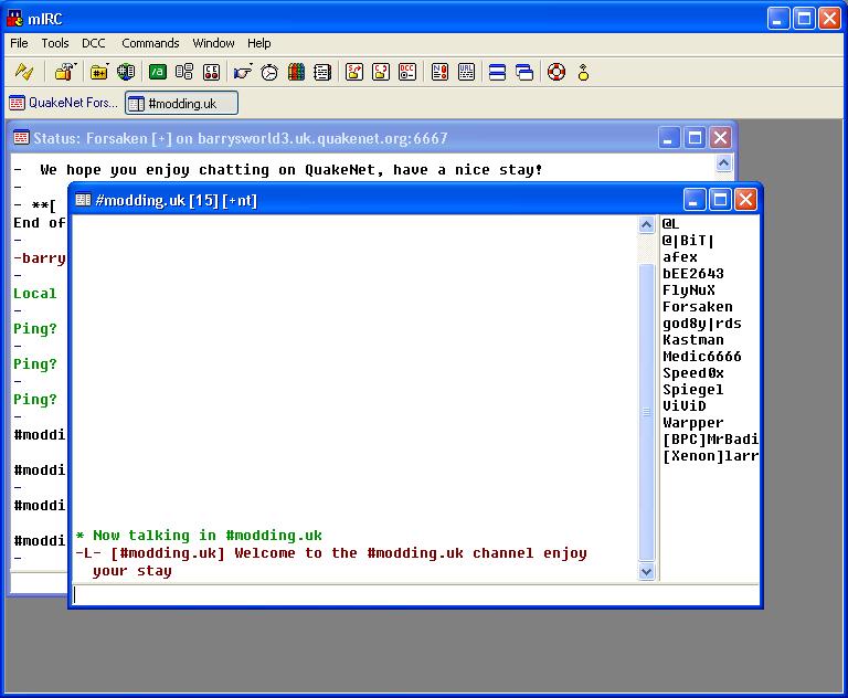

    Enjoy you stay.
    Step 3::
    Talk.
    (mIRC should go stright to Bit-Tech Chat next time you start it up.)
