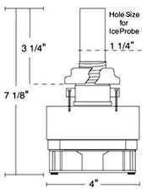

    I came upon this while surfing the net for watercooling stuff. This unit is designed as a cooling solution for small aquariums and insulated fish egg hatching, bait, and specimen tanks. I find it very interesting on their method of cooling the water by using a chilled probe directly in the water to cool it. I think with a little modification this thing could be pretty cool (pardon the pun) for cooling our hot CUPs.
    CoolWorks IceProbe
    Here is a little insert from their website:
    Here is a illustration of how it works. For us imagine the tank as a reservoirs in the loop holding all that chilled water.
    Well I guess I wanted to put this out their and see what you think. Comments very welcome.

    I'm guessing it's a TEC, and with the little fan it's got on the other end, probably not a powerful one. On the otherhand, it probably comes with it's own powersuply etc. Could be quite a cheap way of getting hold of a pelt.

    It is a TEC. Although it can chill your reservoir water a bit, thus giving your cooling a slight edge, you have condensation to consider. Not worth the hassle, IMO.

    Plus thanks to ineffeciency, you'll still have more heat to deal with. It'll just be in a different location. Chances are it won't chill the water to beyond the dew point (where condensation would become an issue), and likely won't make a significant difference anyways. Unlike a fishtank, a significant amount of heat is constantly being added to a watercooling loop.

    The condensation to consider? This can bring aquarium water down 6-8F. Big whoop. That's room temp water with little to no heat addition. Now try flooding that water with about 400W of heat from your lurvely X2 and SLI'D VGA cards. Am i smelling a smoking Pelt yet?

    Great feedback guys, concidering this unit is designed for cooling aquarium water and not cooling water in a watercooled computer system. I think the theory could work if redesigned. I guess just using the TEC would be more better. TY:)
