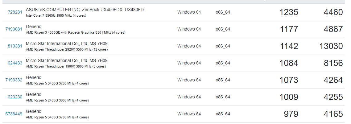

    4300GE is working out quite well, ~7-10w less at idle so machine is around 22w running at stock settings, TDP cap is working well so when loading CPU/GPU it clocks down nice to keep temps/power in check and barely cracks 50w, might have seen a blip to 55w.
    This is just popping it in stock and running ram at 3200, I would be capping speeds and voltage in the final device, still in its stock TDP capped form its enough to run CPU at 8 threads at ~4.1Ghz when GPU isn't ding anything, very good start, seeing as it'll be headless ultimately.
    Its my strongest AMD CPU in single thread :( :D

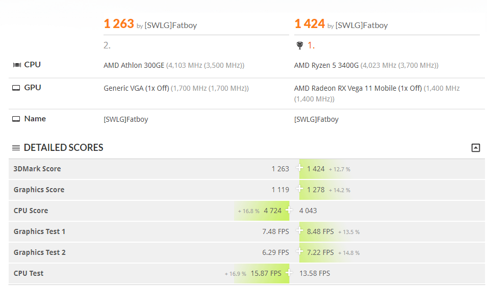

    As is low end desktop chip its not a million miles away from the 3400G stock v stock in timespy the 4300g does well despite 6 GPU cores versus 11, so a Zen 2 full APU would be quite nice if they ever release them to the general public (this is an OEM chip I bought from quietPC)
    If you can uncap TDP and up GPU clk it'd probably be as fast if not faster than the 3400G as the iGPU in higher specs clocks ~400Mhz higher even with more CUs, none of this is important for how I am going to be using it, I just thought it was interesting.

    Thanks for sharing the numbers, interesting to see.
    You said the 3400G was a disappointment compared to the 2400G, which is evident here.
    I'm surprised, what do you think accounts for the lower performance?

    Actually what I discovered was that there is a quirk in the BIOS that does an all core overclock of the APU when you change GPU clockspeed and so the 2400G was running a tidy all core overclock due to BIOS, they basically all run at max boost clock:eeek:, Asrock does say you shouldn't run this BIOS on Zen/Zen+ perhaps this is why.
    You'll see the 3400G in this list twice once stock and once with the OC quirk enabled it does end up stronger single core, multicore is probably impacted because I spent hours tuning 2400G RAM timings for best gaming performance, really tight at 3400MHz, unfortunately the 3400G couldn't run to the same level of aggression and I couldn't spend any time on it as my daughter was using it for school work, so that is probably 3400 CL14 tuned timings vs 3200 CL16 XMP.
    Found the same thing with my Threadrippers basically Zen+ improved memory controller couldn't hang with Zen if you were to dig into all the tertiary settings.

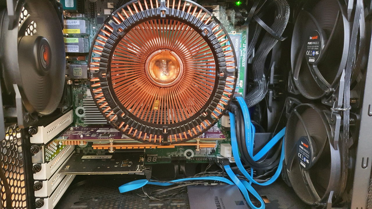

    Asrockrack x570 board on route this morning, completely unnecessary, overpriced and no doubt uses far too much extra power for that IPMI hardware and the x570 chipset for my use case, but sometimes it's nice to just dick around with new (to me) stuff :rollingeyes::blush: will be nice to be able to remote into it prior to boot and see what is what, with my HP I have to take it around to an old monitor to get its VGA output running sometimes when I've done an update and something doesn't fire up as new screens don't do VGA and the myriad of adaptors I have that do VGA to HDMI don't work with all text style outputs and controller BIOS screens etc :rollingeyes:, so can definitely see the benefit.
    fingers crossed its all sorted in respect with IOMMU etc and the IPMI works as well as the vision in my head thinks it will :D
    Going to pop it in a Fractal Node 804, a bit on the big side and perhaps not the best case design but lots of space for expansion and cooling.

    Well IPMI is handy, installed it lunchtime, it wouldn't boot, I could see it doing something but no output, logged on to the IPMI, this thing definately uses power by the way, a good 7-8w in standby is being used, must be that, anyway, updated the BIOS, still didn't work, used the remote desktop functionality to enter the bios on the machine and could see that the machine was setup to display graphics over PCI Express, despite no such card in the machine (unless the IPMI counts?) Set it to HDMI and we are away. :cool:
    Still the things that fail over HDMI also fail over IPMI remoting it seems, I get mad lines over the display when installing openmediavault and it also happens with remote display over IPMI so for that posrtion I'll still be walking over to that old screen, dammit :duh:
    That x570 chipset is a toasty mofo, will probably need a fan.
    Now to build the rest of it and get all my software going, hopefully I succeed and the machine won't be on marketplace in three months when I have realised I was being to ambitious and buy a QNAP :D

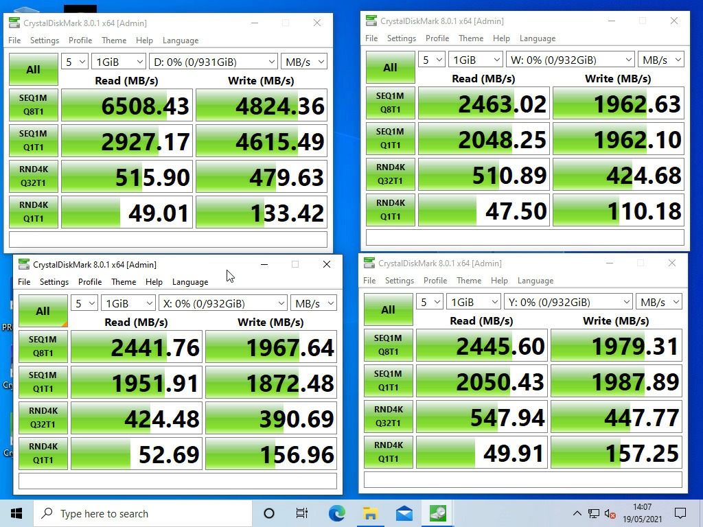

    So a month on, how has it gone........
    Not so well, still don't have a functioning NAS :blush: I did at times and the machine was flawless, VMS webservers and everything else, superb, pretty good hardware
    But I had a modern x570 chipset and access to new gear so it's become a fun little toy for experimenting with things, mostly me trialling hardware such that I can switch from my old HEDT platform to a much cheaper Desktop platform. Having fast storage on my NAS I have convinced myself, that I could fit a couple of NVMe to the NAS and some to my desktop and do somethings off of the NAS which would ultimately archive to big spinners.

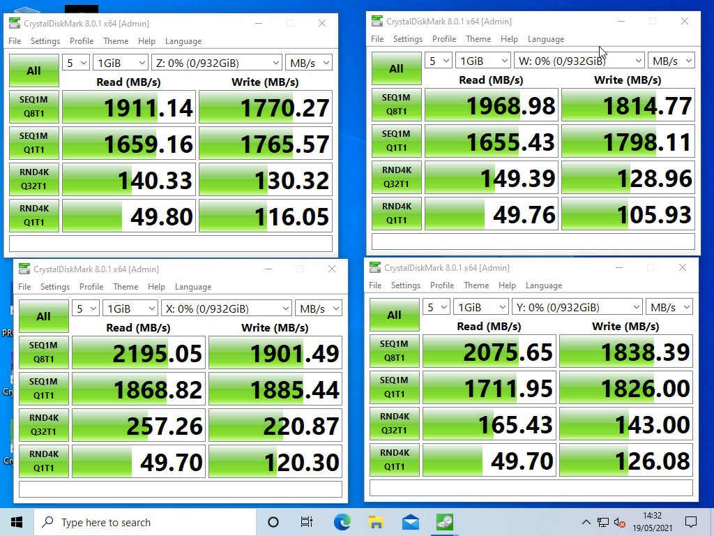

    So first failing of normal desktop is not enough lanes to run NVMe drives I already own, I spotted when looking at QNAP that they have Quad NVMe cards for the NAS, they include a PLX switch to. mux the 4x4 lanes down to 8 lanes, sure you wouldn't get full speed but you know how it is you move from 1tb to 2tb to 4tb etc etc and end up with a load of old drives that are still useful, no problem in a Threadripper, it has all the lanes, x570, well any desktop setup no such luck.
    This Qnap card will work without PCI-e bifurcation and in testing on some old 1Tb drives very little impact in performance, clearly if you raided all 4 you would saturate a PCIe3 x8 slot but its not slow.
    single performance of 1 of my drives ( 3 shown, not top left that is 2x 512Mb striped in windows software)
    If I fire off all four of the 1Tb drives obviously there is a knock on effect but you know it is still not slow.
    So in summary, nice bit of kit with a small fan that is silent unlike the rubbish in my hyper x16 from ASUS, they have a pcie gen 2 and gen 3, obviously it would be better if I had gen 4 but the QNAP QM2-2P-384 will just drop in to any machine and show 4 independant NVMe and seems like a quality bit of kit, it is £140 though (under £100 for gen2) so you might not find value in it but as I have drives and want some slots it works for me, I was previously looking at some Aplicadata card or some such that is twice the price for the same thing, so seem like a bargain.
