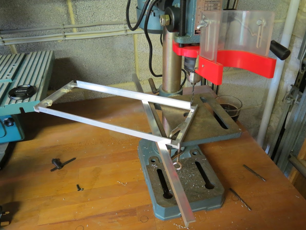

    Drilled the holes to attach the front (hex screws) and rear (rivets) panels today, as well as gluing more of the chassis together.
    The longer strip of angle is just there for support, if you look carefully you'll see why it's clearly needed and the ideal thing to use. Note also the position of my coke glass.
    And here are the 'after' shots. First, Pepsi.
    Complete with Aluminium filings. I was feeling a bit low on Vitamin B12 anyway...
    And the holes here, pictured is the front panel, with 3.2mm pilot holes drilled, prepping for a 4mm drill to fit the M4 hex screws - not sure of the correct term, they're not hex head, they're round head with a hex/allen face; if anyone knows please enlighten me :)
    So on to gluing - I fitted the bottom two angles today which will connect the front and rear chassis parts (pictured in earlier posts) together.
    Here's the Araldite applied liberally, as it semi-exploded and started coming out from the bottom as well as the top -_-. Plenty wasted. I'll be emailing for freebies.
    And finally, here it is all shaping up - the beam on the top is just balanced to give more of a pictures, the bottom two are only glued on the left (what will be the front).

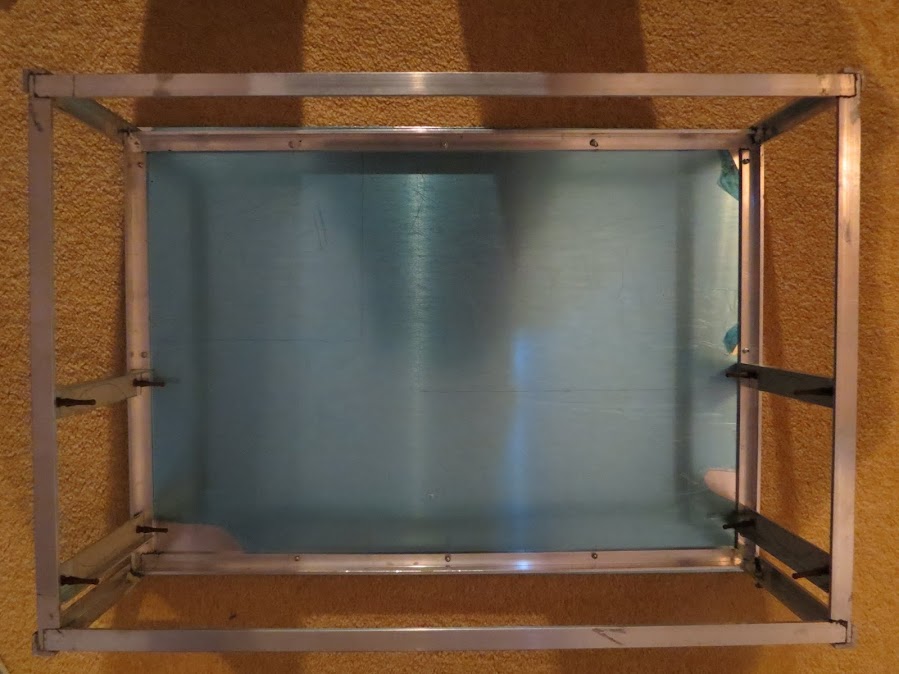

    I meant to post this a few days ago, just to say I'd drilled the holes for most of the side panels. I didn't take any pictures, it looks just like above, but with more holes.
    Today I affixed the bottom panel, though unfortunately I hadn't quite made the chassis perfect to the millimetre. With hindsight I should have left ordering the panels until I could measure the actual sizes I'd need, rather than trying to build to it.
    Ah well, live and learn, not sure what I'll do about the overshooting bits yet. Maybe just leave it, and buy a bigger panel if I'm ever bothered enough.
    I'll post pictures with the panel on later.

    Here's the promised pics of progress:
    Bottom panel riveted on, and some patching up of the chassis (mallet and file used to apply pressure for the Araldite to take hold).
    One of the rivets failed, so I just took a hammer to it. Tougher than they look though, I had to bend it over rather than squash it.

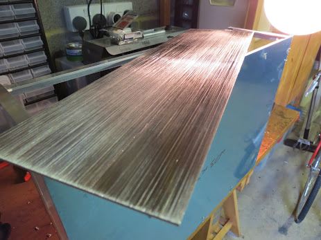

    Today I tried out brushing the aluminium on what will be the inside rear panel. Or not used at all actually, I've got two rear and two front panels. Two of each size, and the front and rear are slightly different. I got two anyway because obviously I'll have to chop bits out for BD drive, power switch, mobo I/O, etc. and it might go wrong :p
    But I digress..

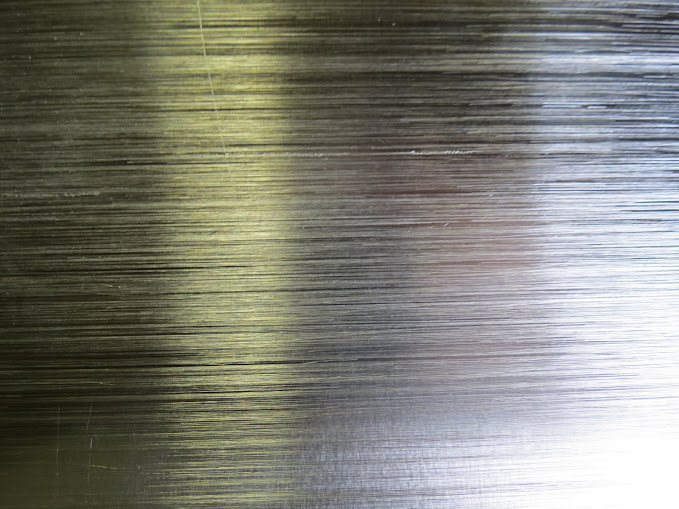

    I used two grades, first a 120, and quite liked the look of it:
    I meant to get a picture of my wood-masking-tape-clamp contraption to keep the lines straight, but totally forgot. I'll take one when I'm next out there.
    I was pretty pleased with that grain to be honest, once painted I thought it would have the effect I'm after, but I tried moving up to 240 anyway:
    And liked it even more. Might not seem very different in these pics, but in person it just makes it seem more a of subdued modern look, than a loud clashy vandalised look.
    Should look even better when I do it on the clean and shiny sides (that are still wrapped currently) - this side had some pretty deep scratches on it from being unprotected.
    One last one:

    Back to brushing, here's the pictures of setup I forgot to post the other day:
    Basically I just taped the sandpaper (grades 120 and 240) down to the bench, and I've clamped some scrap ply over the top the correct distance apart to guide the alu sheet to get straight lines.
    Just a simplified version that's described (but unfortunately not pictured - I couldn't quite understand his setup) in this thread.
    Here's the sheets after 120:
    And 240:
