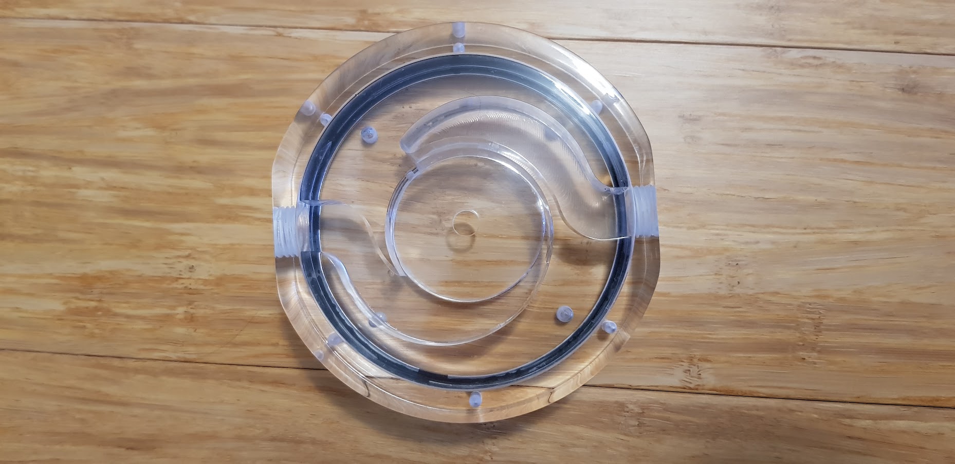

    This part also arrived from the CNC, and I polished it like the waterblock with 600 up to 3000 grit wet and dry, then Turtle Wax polish. This is the pump top and it slots inside the next part, and seals with an o-ring around the bottom:
    This next part is the cap for the CNC'd part. This made on the lathe starting from a block of acrylic like with the waterblock, then alot of polishing:
    Here's some pics of how the parts fit together. The very outer edge and fitting wont be visible, and I'm going to play around with various materials and lighting on the sides and bottom:

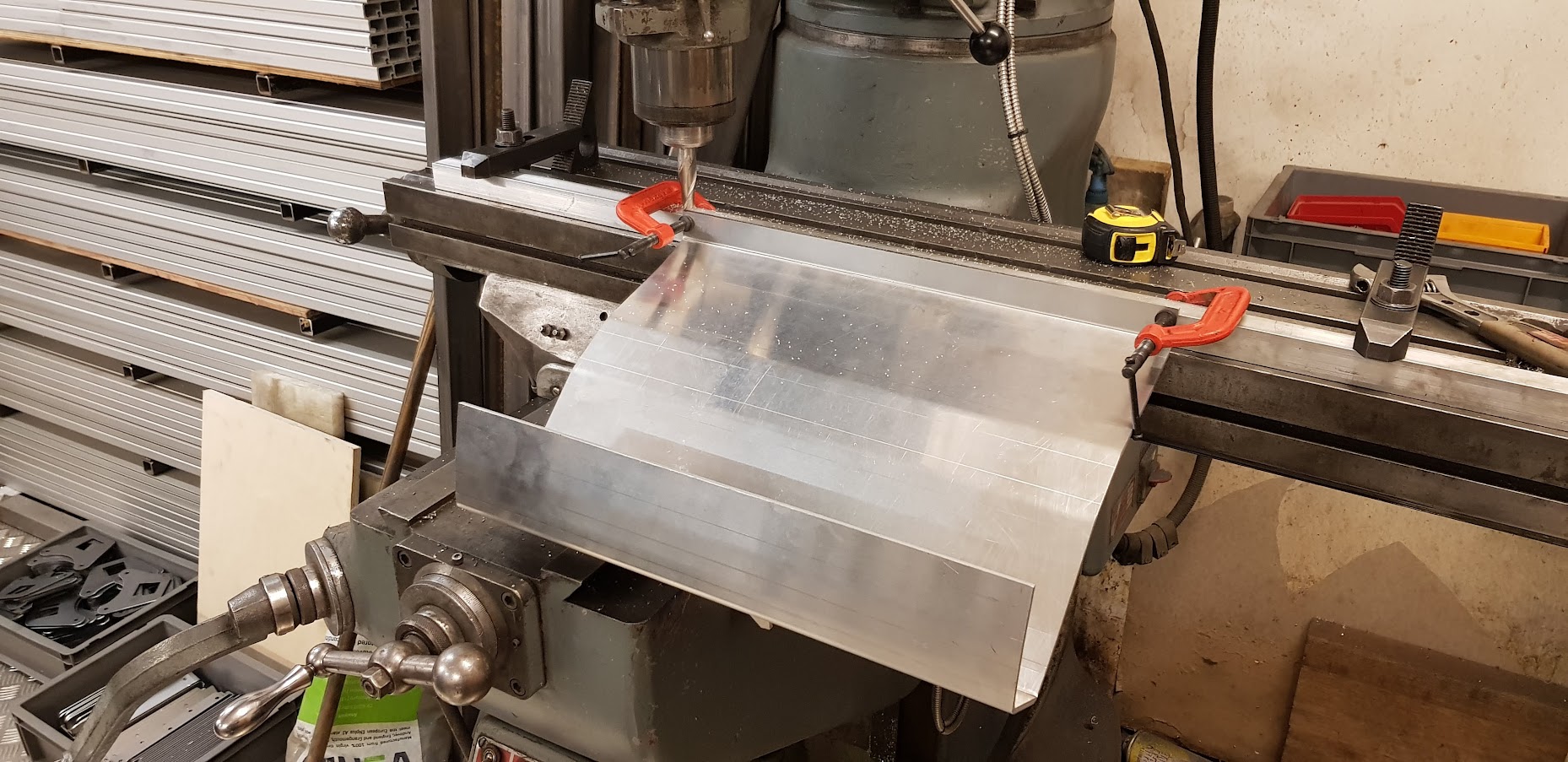

    Next up was milling out the pattern in the side of both halves for the coolant pipe section
    I got a bit carried away and forgot to leave space for the bevel at each end :wallbash: , so looks like I'll be going with a rounded edge design instead. I need to recast the water junction blocks anyway, as they were designed to fit onto a casted wall, not one with welded on threaded studs.
    Again the diagonal bits will be filed down later

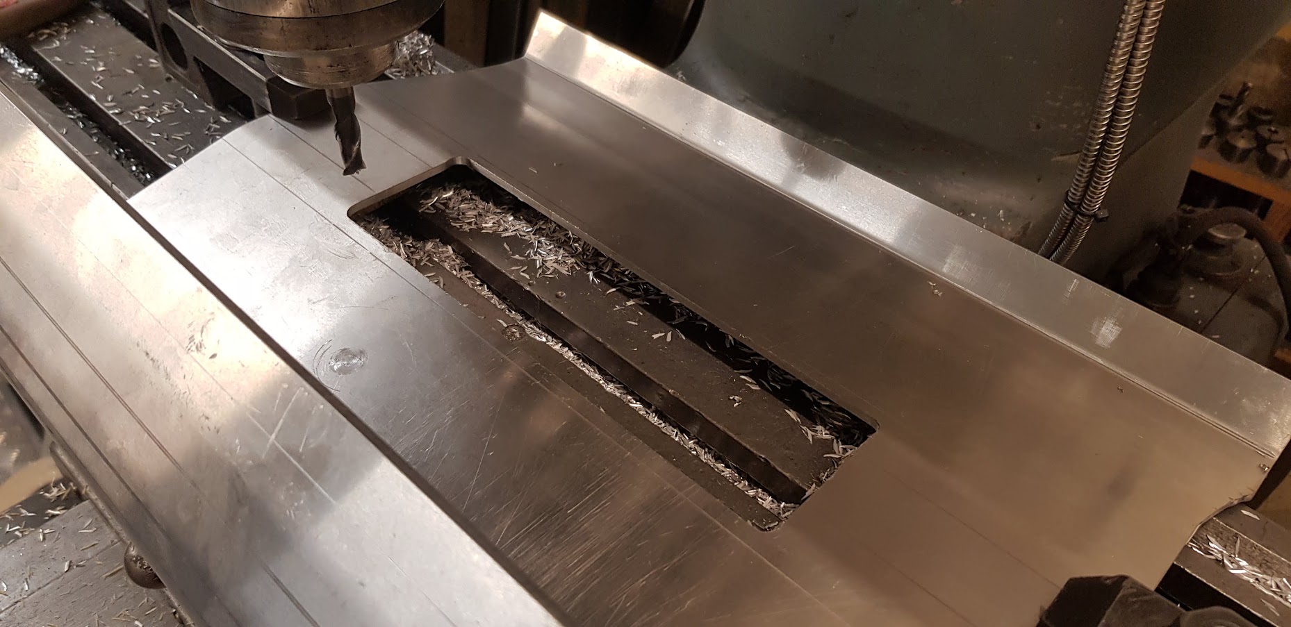

    I then started work on the jig that will hold the parts in the correct position so I can mill the 3 corners
    I was the running out of time, so I just gave it a quick test to see if it was going to work
    It worked a treat, but its not quite level level after the welding, so it needs re-skimming again to make the whole jig flat again, then it will be good to go :happy:

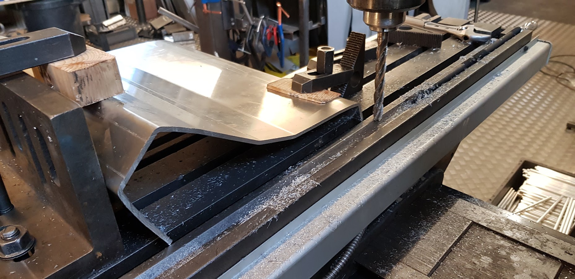

    I skimmed another layer of the top of the Jig to make it perfectly flat again:
    I then clamped the first part down onto it, and began to mill out the large cut-out section:

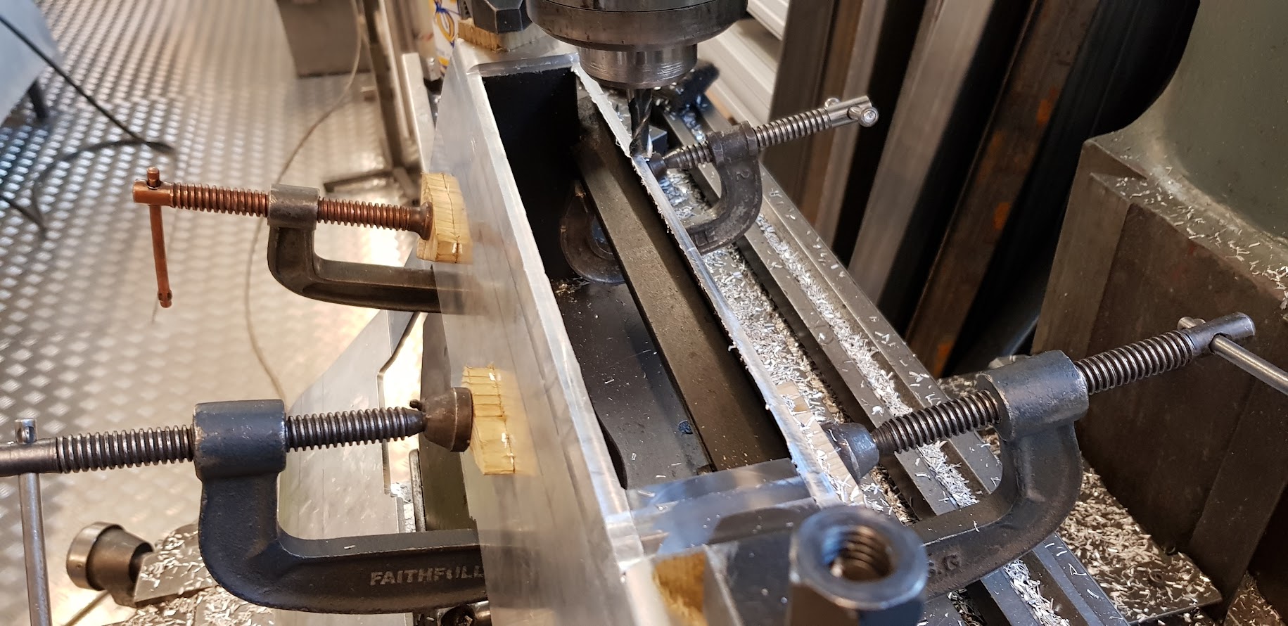

    The big block of alu arrived too for the back panel so next up was to manually mill out the shape of the panel. I gave the top and one edge a quick skim over with the face mill and end mill:
    Then figured out how to mount the thing as the milling table is barely wide enough, while also giving room to mill out:
