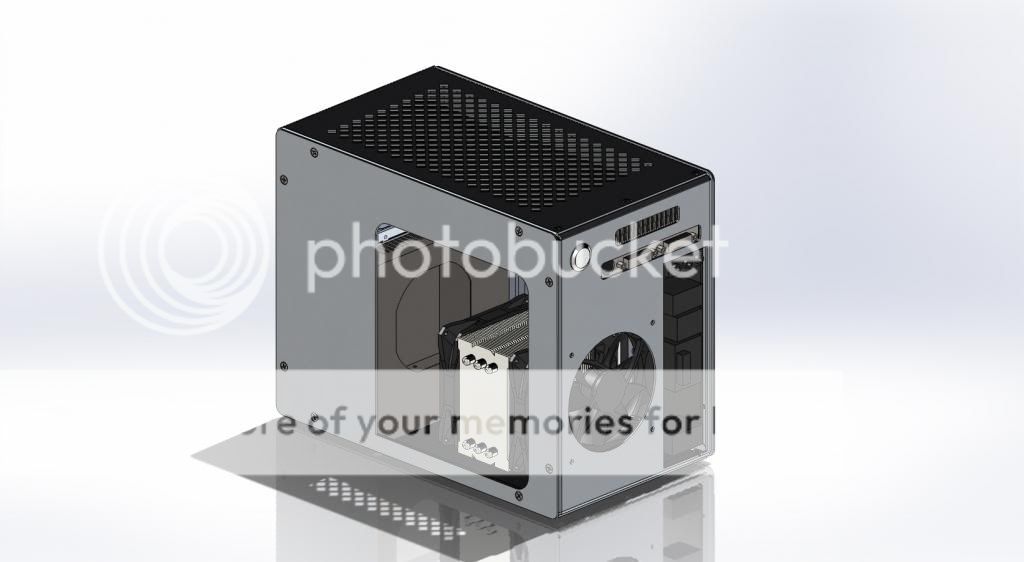

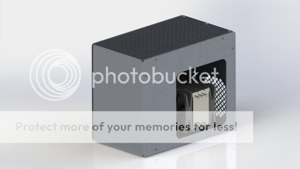

    Well ive never done a build log on Bit-tech before but I sure have looked some over. Seeing all these wonderful builds inspired me to slap together some old hardware and make a case as small as I could around it.
    I know the hardware isnt the best but hey, its paid for and just sitting idle on the shelf.
    So for hardware i have:
    Zotac 775 socket mobo
    Adata 1600 meg ram (4 gigs)
    Good ol' Q6600 Quad core
    GTX260 GPU
    Rosewill PSU
    640gig 2.5" WD HDD
    Id love a new small form factor PSU to make the case even smaller but that money is no way in the cards having two little ones at home :D
    So onwards to some screenshots of what I have thus far!
    As I update the model and tweak some stuff in more ill get a good render with some better textures and colors.
    Enjoy my first build log on Bit-Tech! :rock:
    EDIT: And for those wondering im at 9.9L and trying to squeeze all I can out of this to make it small.

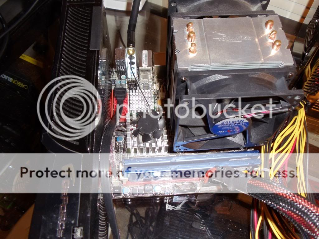

    Here is a quick shot of the hardware just before I hooked it up to make sure everything still works!
    Worked great and only pulled 250watts at the wall with OCCT running power supply test.

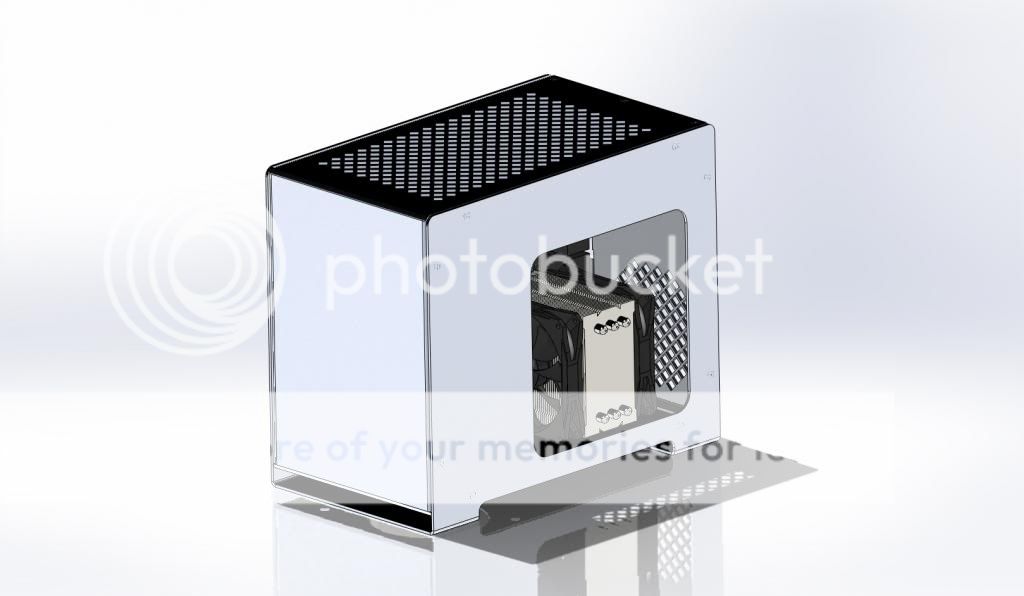

    Here is a quick update from what last night and today brought.
    Happy modding guys:dremel:

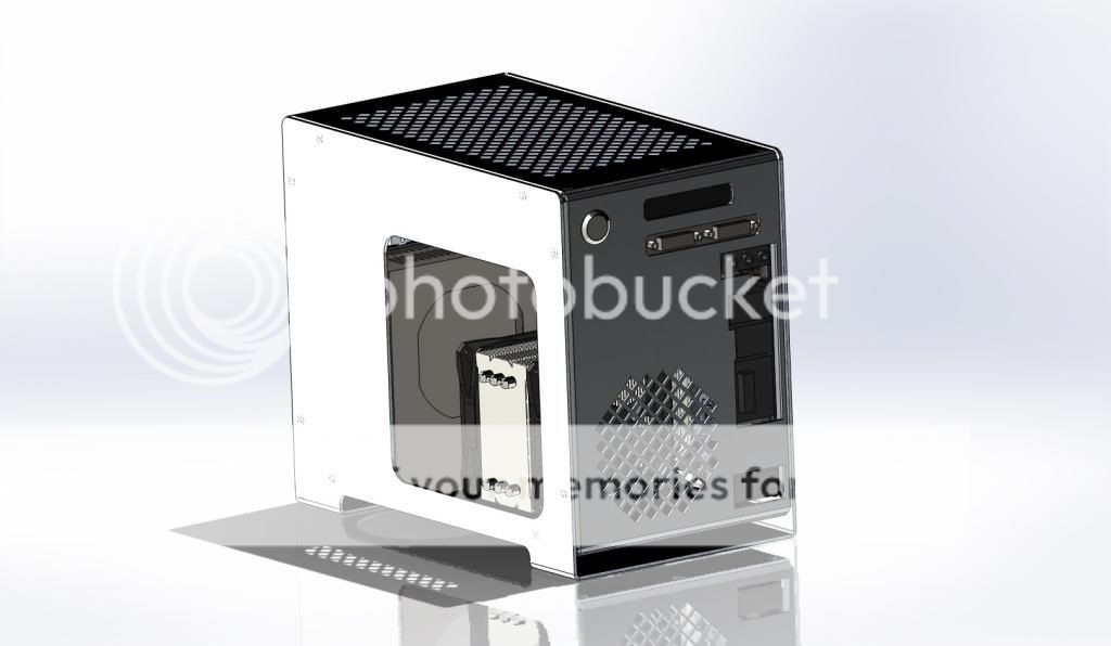

    Ok today's update! Getting closer! Just have a few more little details to fix and then its build time.

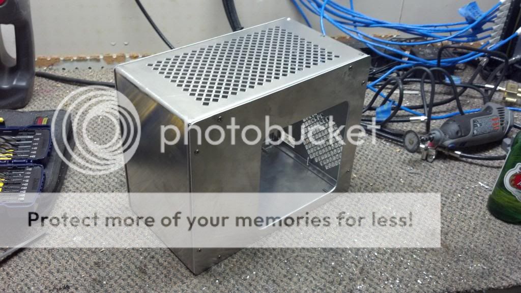

  18. Floyd
    Floyd Wire Twister
    4 Dec 2008
    288

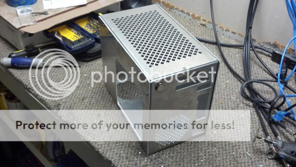

    Sorry that I missed a few "in progress" shots but I think you can get the jist of what is going on.
    I fit checked a few parts and they all seemed fine. Now that the case is together I have to add in the hardware and then work on the wiring and case finish.
    Here is a size comparison against a few random things that I was using:
    And then a general shot of the front and rear. PLEASE keep in mind that I havent done much filing and sanding at this point so there are a few rough edges:
