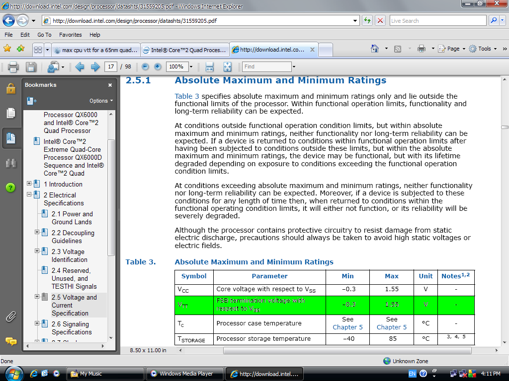

    I know PLL and VTT are used in helping get higher FSB speeds, but I have also heard that with 45nm chips, 1.4v VTT can kill a chip.
    Via a member on OCN who SS a data sheet from intel, it is stated that the maximum FSB Term is 1.55v. If this is true then, you think 1.5v is the absolute max on a 65nm chip?
    Also what is the absolute max PLL you can apply to the chip?
