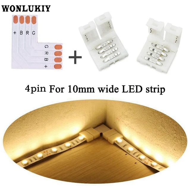

    It seems that I will need an L connector to make a right angle
    Did you have any trouble wrapping the strip around corners?

    The closest I get to a corner with mine is 135deg - see ceiling here - https://i.imgur.com/Oqeq7lR.jpg
    If you're getting it around 90deg corners, I'd suggest a minimum bend radius no lower than ~30mm (flat).
    If you want to do it like the image above, you'll need the connectors. And for any other joins in strips I'd recommend the connectors as well. I soldered a few together and it was quite delicate and prone to failure, whereas the connectors have been perfect.

    I would like to avoid using connectors with the two bends going around the edge of the bed. I don't mind using one for the right angle when I run the remainder of the strip to the floor.
