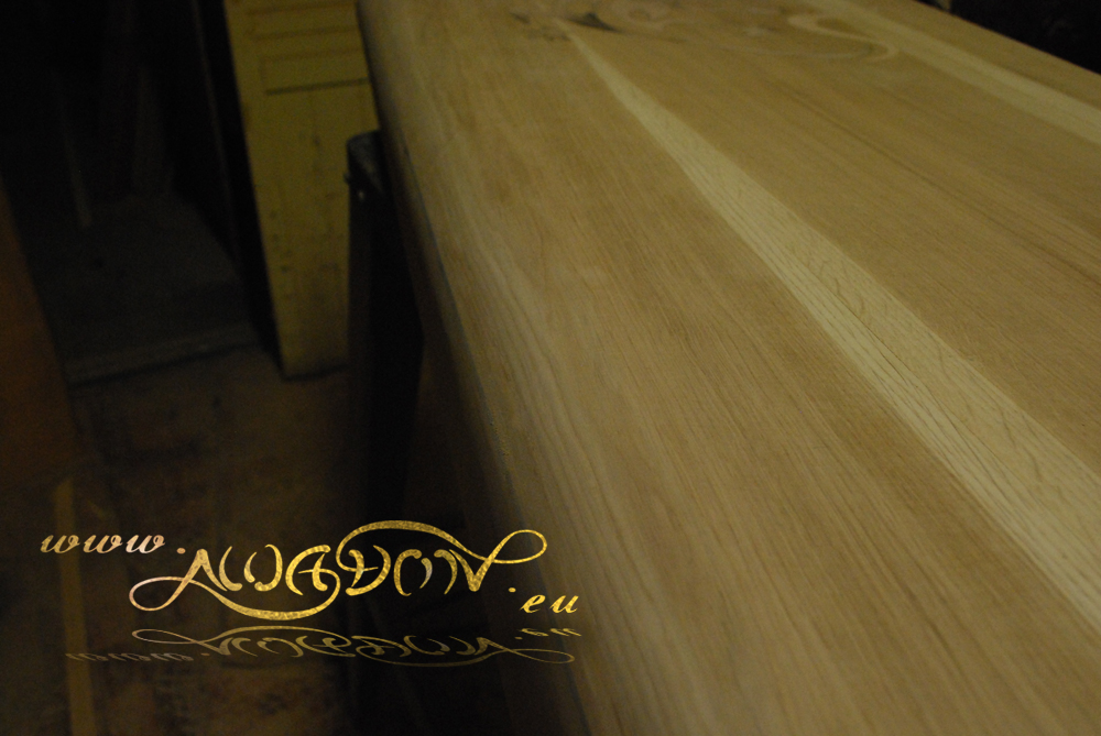

    Long time since I have dealt with modding. It is time for a new case. This time it will be a computer desk.
    As always, I work without a final plan. I just have a general vision :)

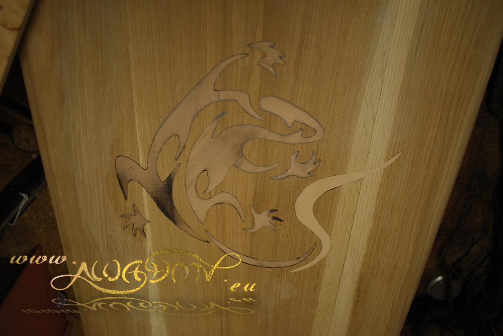

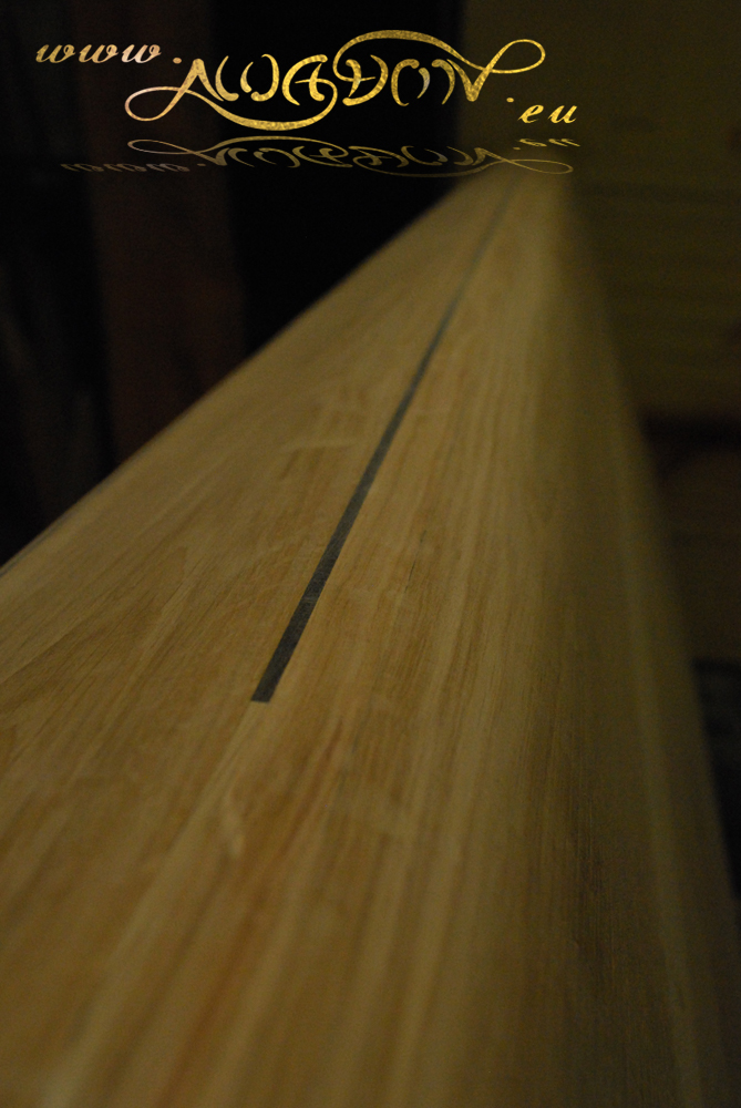

    I've started from the top surface of the countertop. I've glued four oak planks with a total width of 60 cm. Ultimately, I would like to receive the white, smoked oak color. So to spice up the surface I've added some inlay in the shape, you don't guess by looking at the title, lizards.

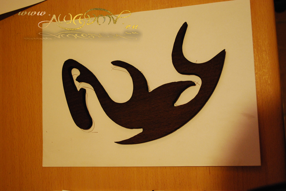

    I've cut out the individual elements, this time with a fine beech wood:
    I've tried at this stage to deep-stain the wood. Unfortunately, the color not sufficiently penetrated the wood :( I'll worry about that later.

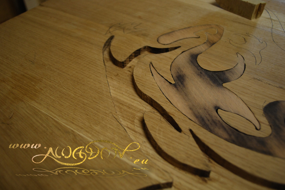

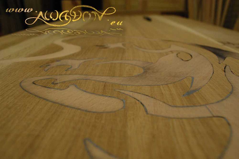

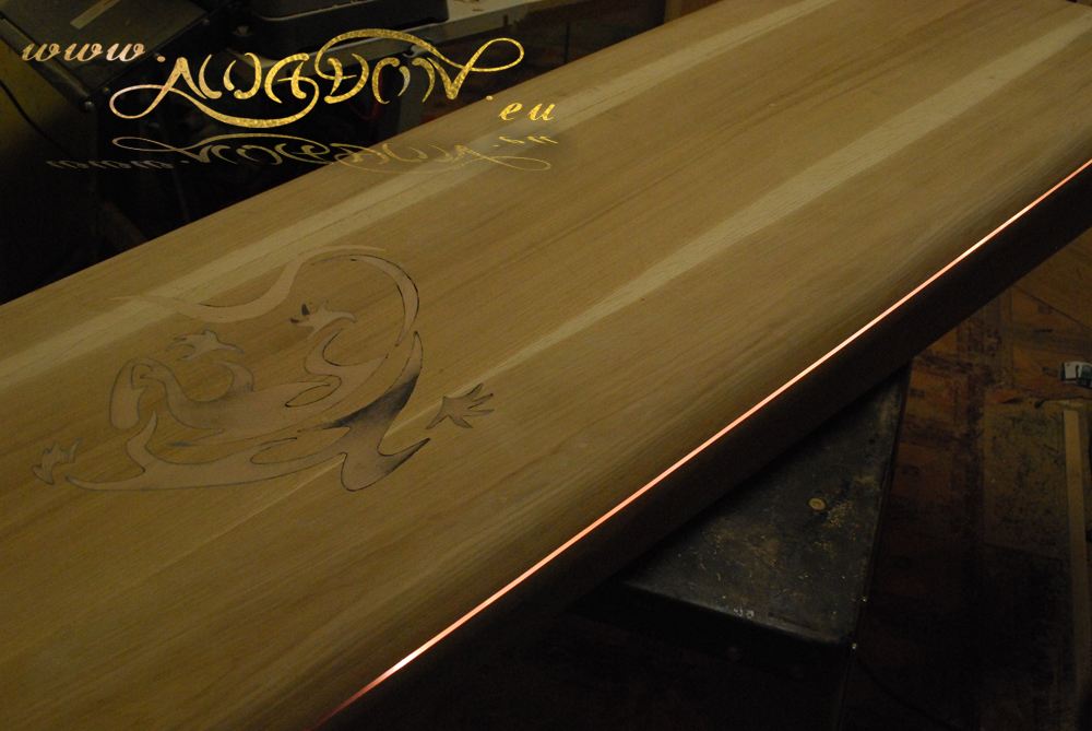

    Now I had to mill the space in the countertop to paste inlays.
    [​IMG]>
    You can see both: the traced outline, milled channel and already embedded element.

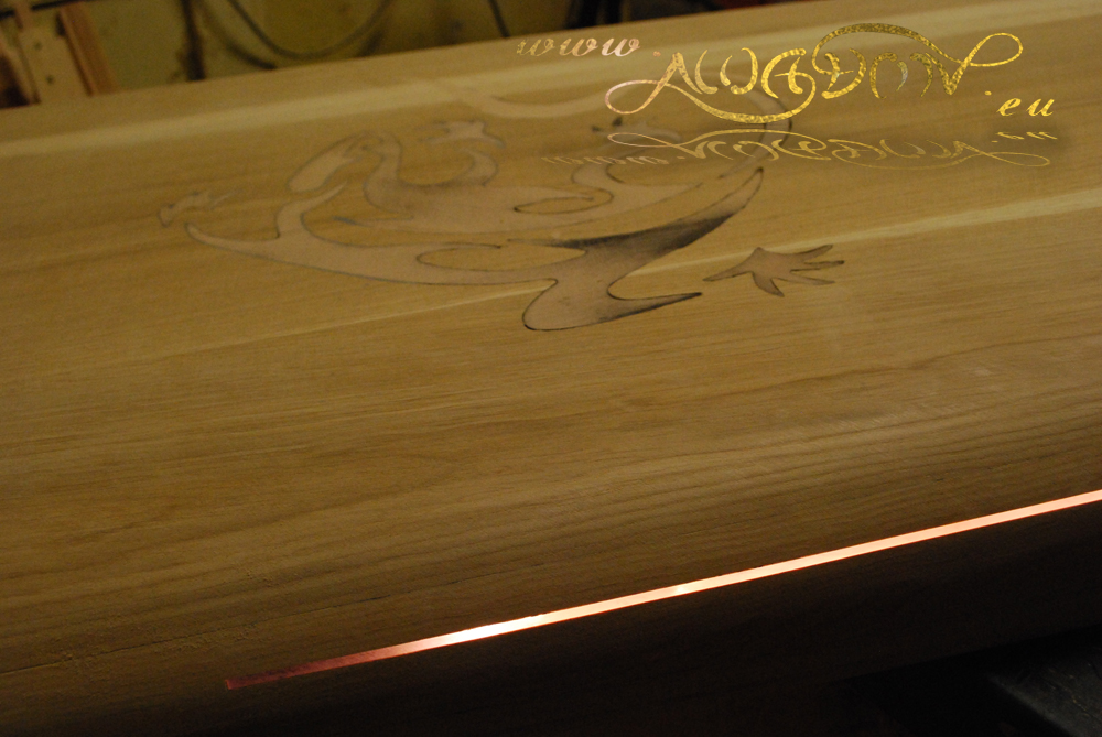

    Two days later, I had the inlay finished.
    There is still sanding and leveling the surface.

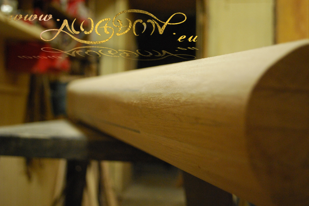

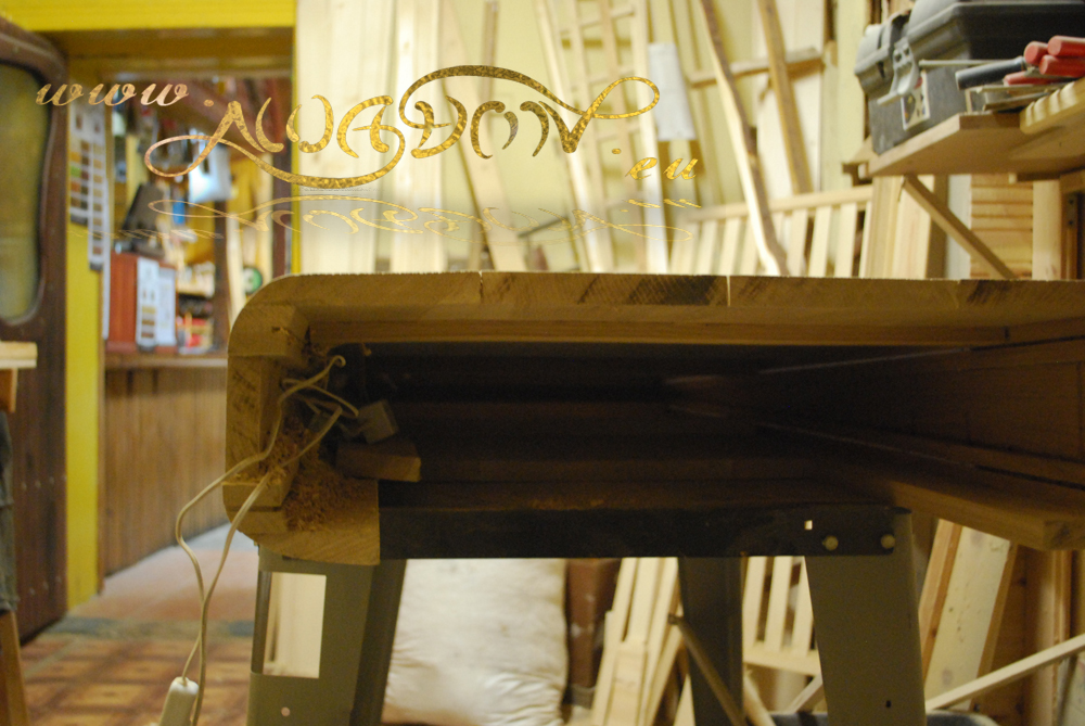

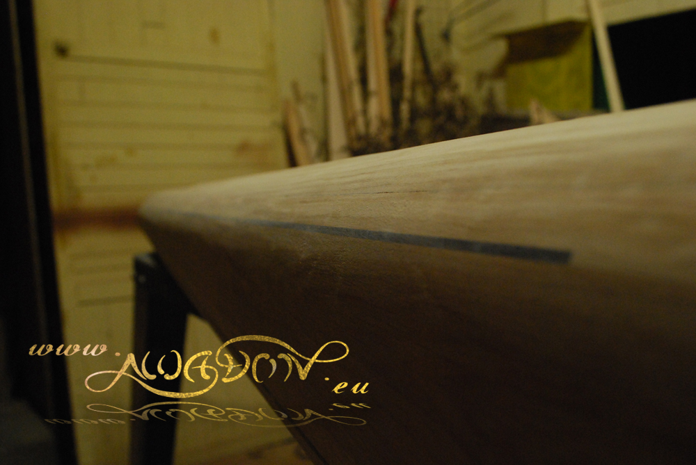

    I want to make desk countertop to be in a wedge shape. That's why I've added the triangular edge bands. Then cut them lightly.
    And then I've sanded them. (Oh, how I do not like this dust).
    A little to dark !!!
    Aziz, LIGHT!
    Ahh, much better. Thank you, Aziz..

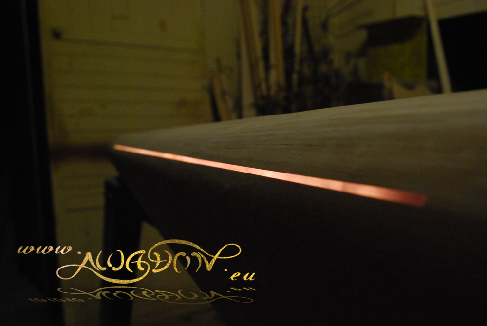

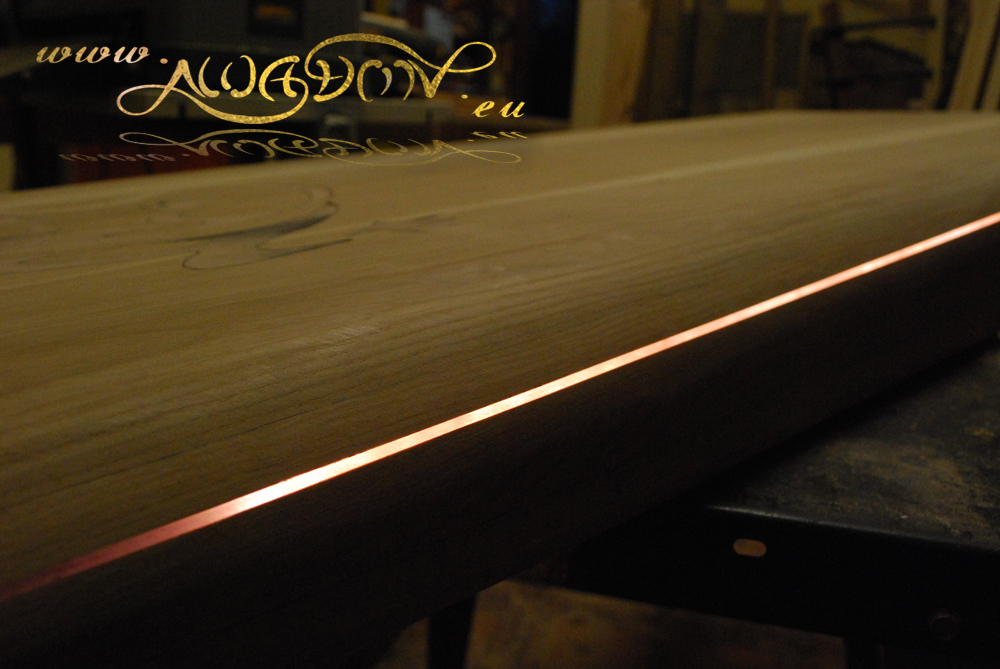

    I've "merged" some pvc in the edge. At the moment it's just an operating test. I wonder what color would be the best here :)

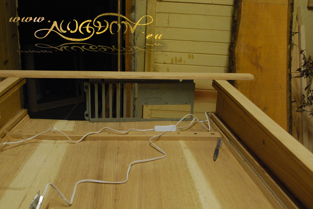

    Success! I was able to precisely determine the location of the motherboard.
    It fits the highest part of the countertop.
    Yes. I know You still do not see anything:) I will try to show a sketch in the near future.

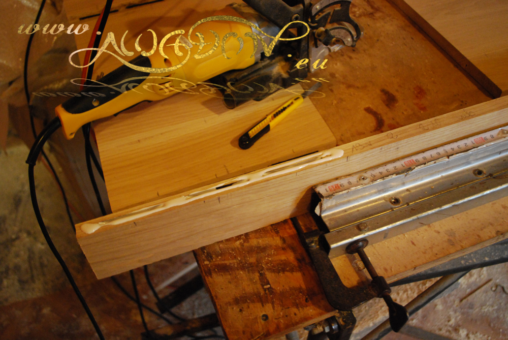

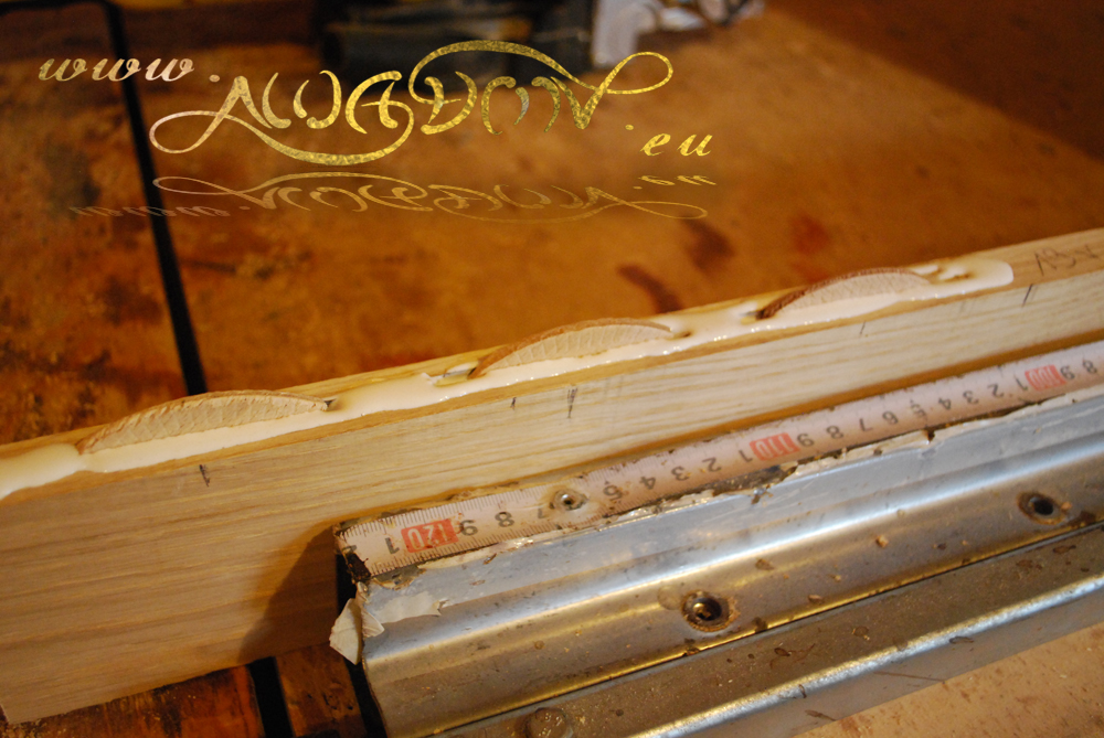

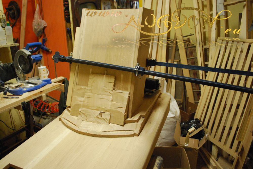

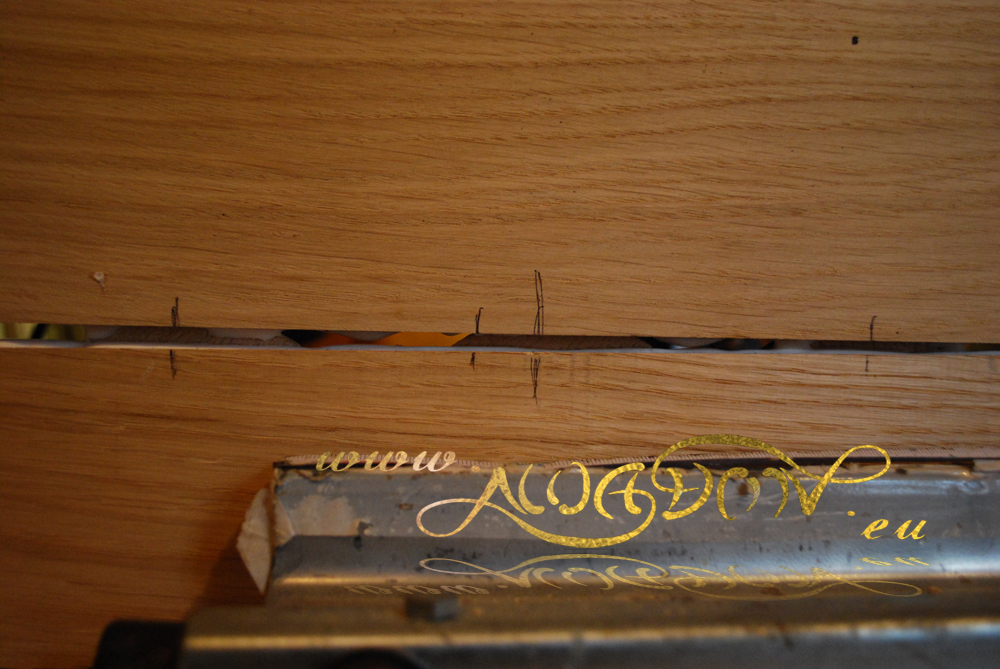

    Some pictures from gluing. I'm using wood biscuits - lamellas.
    There are never too many clamps :)

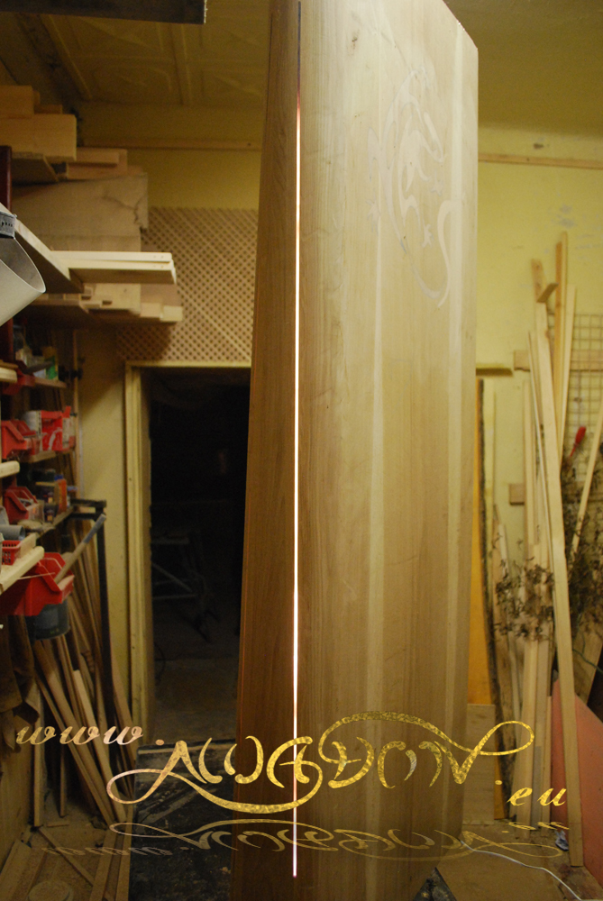

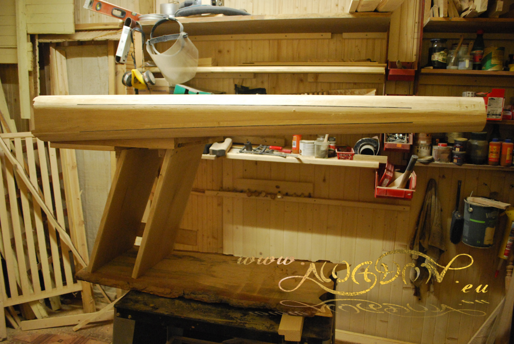

    Deck already took final shape of the wedge. I've sanded it initially too.
    Vertically it would also look nice :)

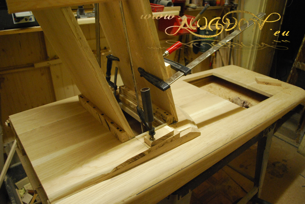

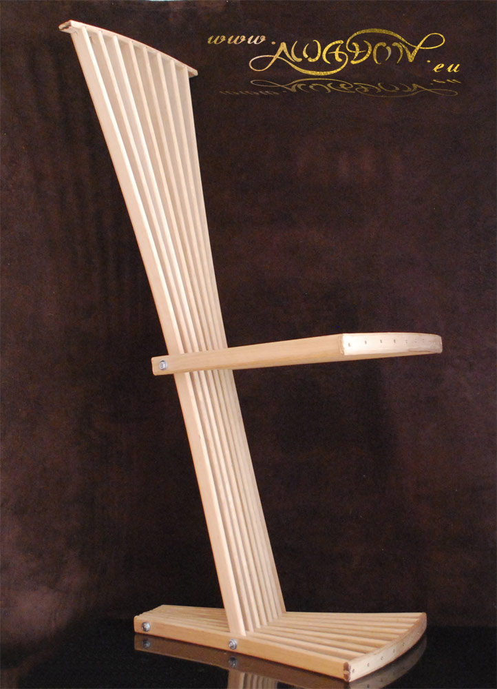

    Thanks :) Of course I will stick to my "old" plan.
    Now I must add a leg.
    And a small test.
  17. Cheapskate
    13 May 2007
    12,579
    2,104
    Interesting concept. Watch out for "that person". -The dumb fat one that sits on stuff.
    If you don't know one of those people, then this will be awesome.
  18. awadon
    awadon What's a Dremel?
    23 Jan 2010
    244
    32
    I believe I can avoid "that person" :)
    I will give him my chair.
  19. Primum Agmen
    Primum Agmen What's a Dremel?
    21 Sep 2012
    74
    You're a braver man than I, I would have added some bracing under that seat to support my 14 stone weight. :D
  20. awadon
    23 Jan 2010
    244
    32

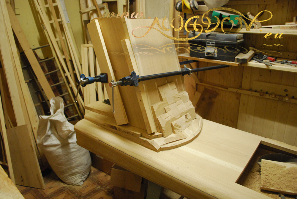

    In order to properly shape it I have glued several layers of wood. Already it is tiring. And as I think about grinding and shaping ....

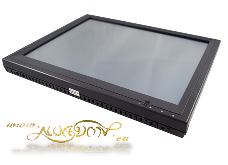

    Today arrived a secondary touch screen - it will be ejected from the side table.
