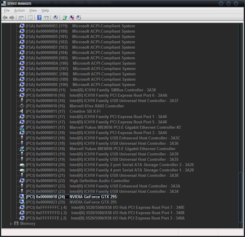

    Is there an easy to check for resource conflicts without resorting to unplugging stuff? I've not had to do this since early Win95 days to get my AWE32 sound card to work ;) Showing my age now :)

    No IRQ conflicts for the GPUs.
    There are lots of shares, but that's normal I'm assuming.
    Each GPU has it's own IRQ though.
