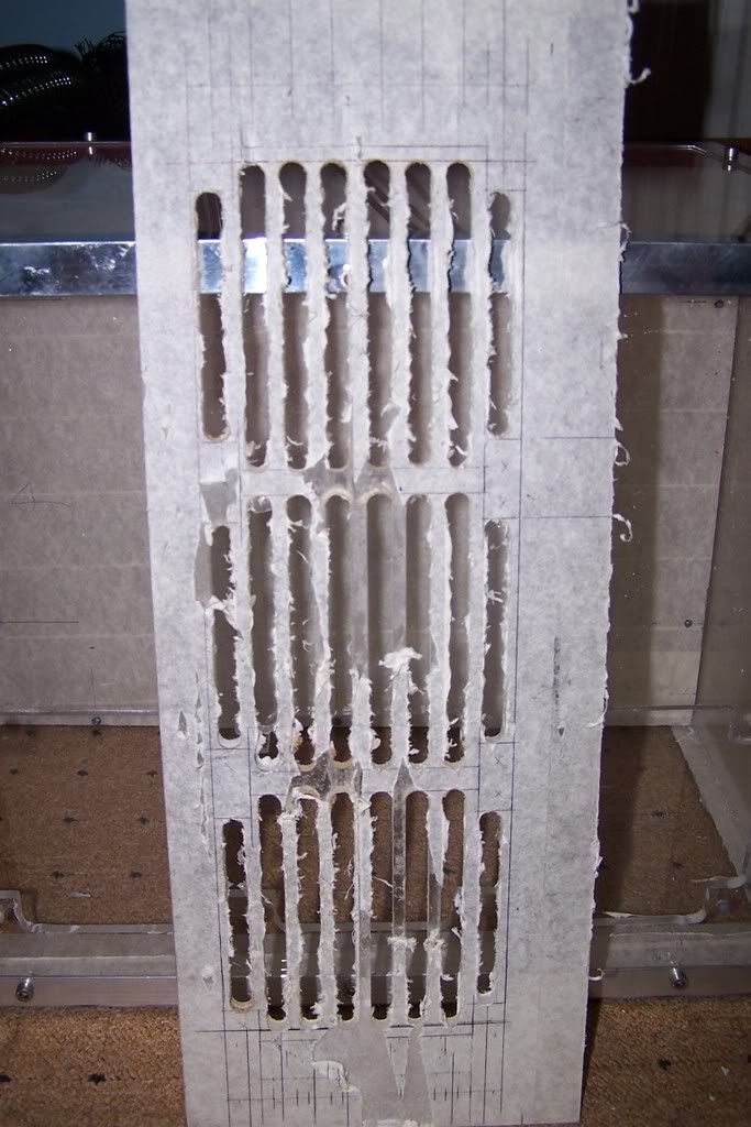

    anyway on with TANGO'd,ive watched scrath builds based on alluminium and plexi for a while now an thought id have a go,one thing i noticed about alot of the cube type cases was the way the angled alluminium frame was riveted together and the plexi was fitted on the outside,wanting to be a little different i decided to put the frame on the outside and mitre all the corners.
    the size of the case is always determined by what is gonna be installed and as i was gonna be water cooling with 2 triple rads an be using a 1000watt psu i was gonna need to go fairly big
    once the rad holes were cut and filled(sorry no pic of the filled holes:() i had to think about the rad grills and after a few hours of looking decided i was gona have to make them myself,so armed with my router a new 10mm bit i was off into the shed to try my hand at making a rad grill and i must say im pleased with the results
    after some filling i fitted it to the side panel,once ive cleaned all the cuts im gonna be painting it black to contrasr with the orange ive painting the side
    a quick look from the other side so you can see the size of the case
    i want too sure how to finish the frame so decided to polish one of the angles an im liking the look so im gonna be polishing the rest in the coming week.
    sorry about the lack of pics,but it started as an experiment to see how it would work out and i just kept liking the results and carrying on.
    any tips on finishing the slots on the rad grill?????was thinking bout having a go at flame polishing but i think there too tight and as i havent tried it before didnt want to ruin what i had already done.

    Finishing the slots on the grill? -Sandpaper on a stick, or wrapped around a pencil.
