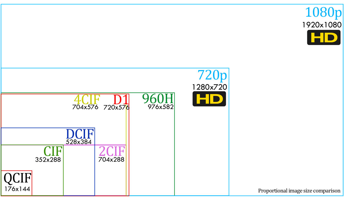

    Firstly, your current setup is poor, I appreciate it may look OK expanded onto a 1024x768 screen (circa 1998) but on a HD screen it lost all detail, how do I know, because I viewed your sample recording (352x288) and on my 24" HD screen it opened in a window about 3" square and at full screen, just forget it.
    So let's move on to a complete HD system, and I notice you currently have PoE which is a bonus, my original quotes related to analogue systems but you're setup for digital with your wiring (cat5e) which puts the price up a bit, but is of a even higher quality, especially in night vision.
    Now I don't know your budget, but what price for decent security?
    a 4x 960P system is around £150 and 4x 1080p £220, these are complete systems without HDD, you can pay about £60 more for a 1TB fitted, but if you have a SATA drive kicking about or even buy your own you can get 3TB for that money, just open it up and plug it in.
    I've had a 4x 1080p analogue system (£130) for over a year, got to be one of the best things I've bought, there is only one drawback I've found, this is a 16:9 system and shows that way on my TV (HDMI) and mobile devices (cloud) but when i view on PC via IE11 (network) it's in a 4:3 window so appears a bit squashed.
    The systems I refer to are Sannce/Annke they have shops on both Amazon and Ebay, i will link to Ebay, you want PoE, filter by cheapest and keep scrolling until you get to 1080p http://stores.ebay.co.uk/SANNCE-Security
    If you still are unsure about the levels of quality take a look at this link, your current system is known as the CIF standard, compare it to 1080p http://www.camvex.com.au/images/ResolutionChart.jpg
