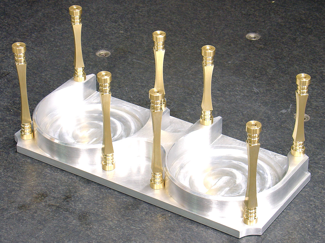

  5. G69T
    G69T CNC Modder
    6 Jun 2004
    570
    15
    thank you all for compliments

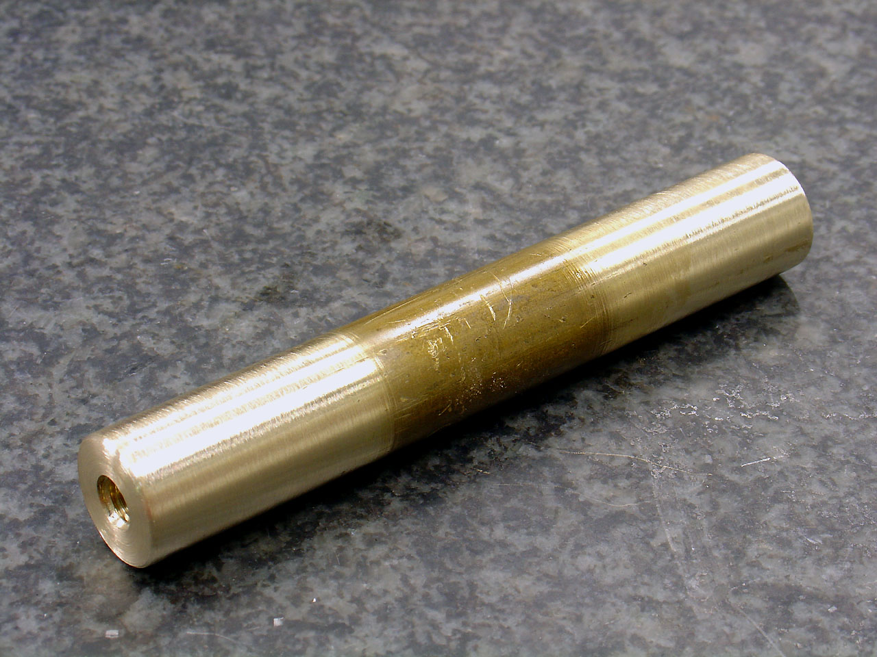

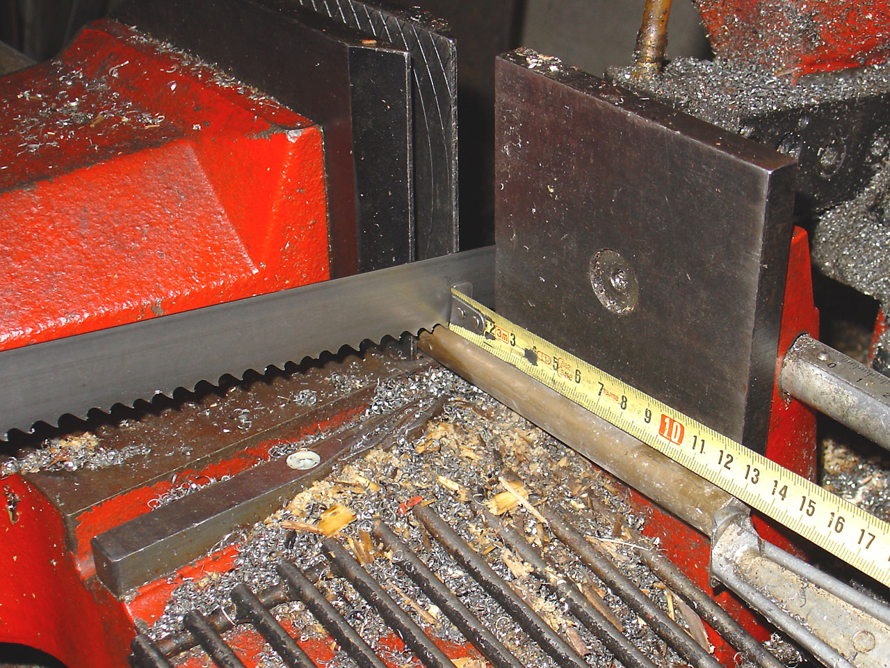

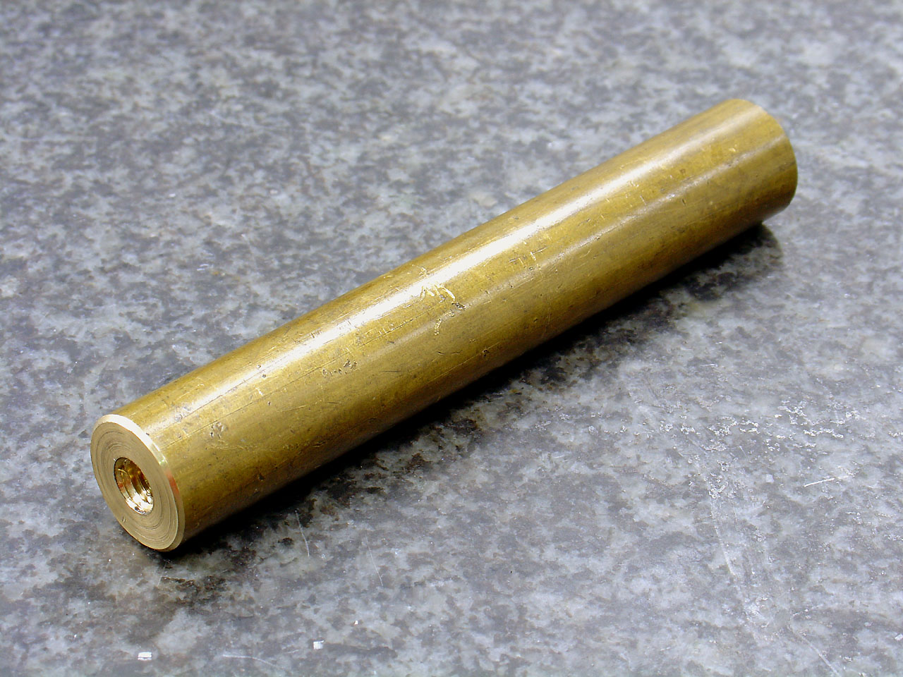

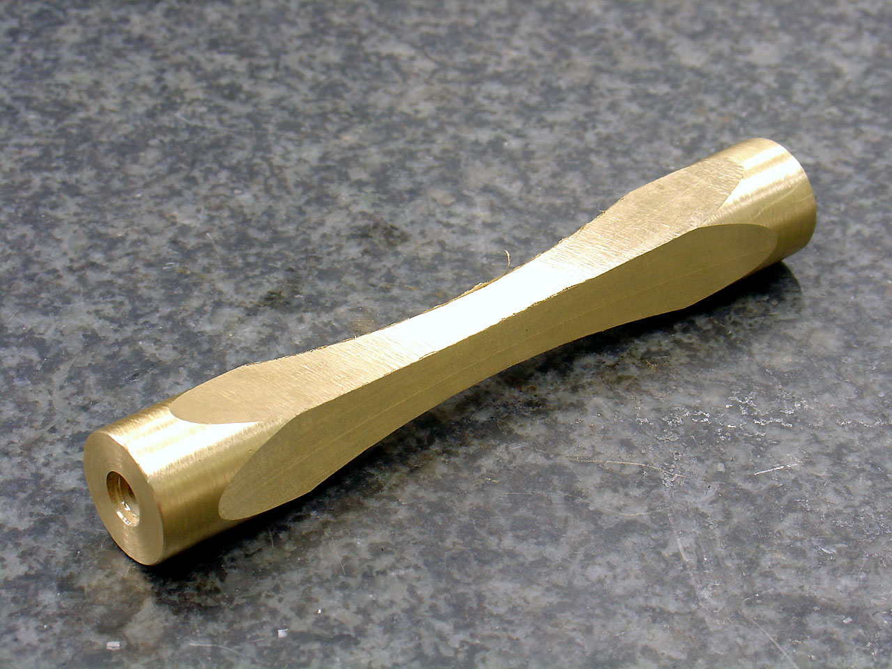

    First phase: bras columns workship.
    Zoom the cutting of bras bar (D. 16mm.)
    Zoom halfworked column with manual lathe.
    Zoom half polished of bar top.
    Zoom Worked column with CNC milling machine.
    Zoom At the end 4 frontal columns and 4 rear (shorter) polished and ready for the 2nd phase.
    bye bye :thumb:

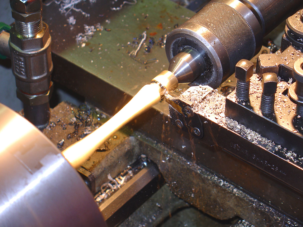

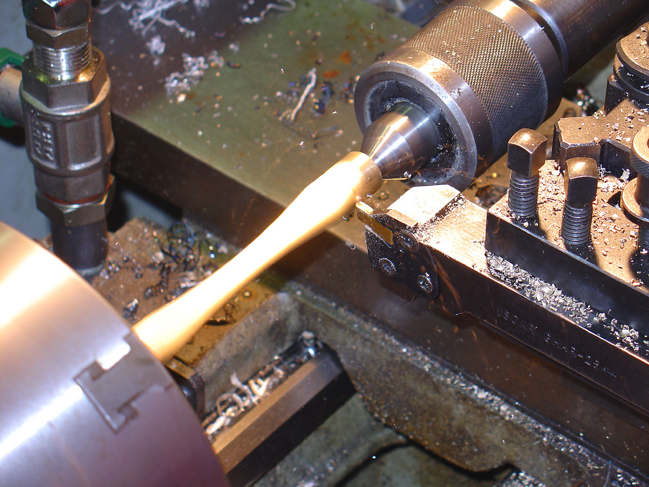

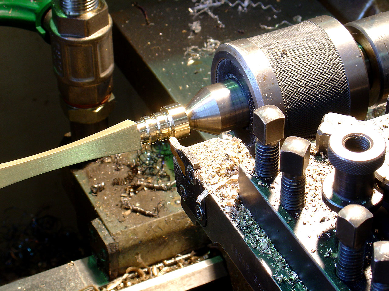

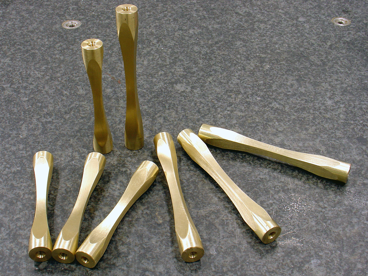

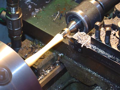

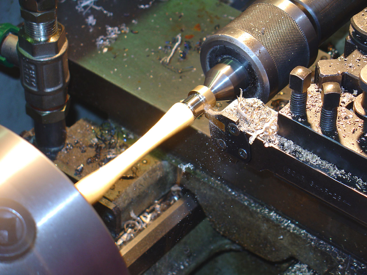

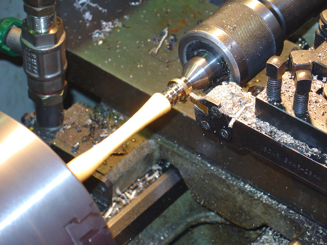

    2nd phase: brass columns.
    the tops workship with a manual lathe through a radial top tool (thickness 3 mm.; R. 1,5mm.)
    Zoom
    Zoom
    Zoom
    Zoom
    Zoom The finished column fixed on the lathe.

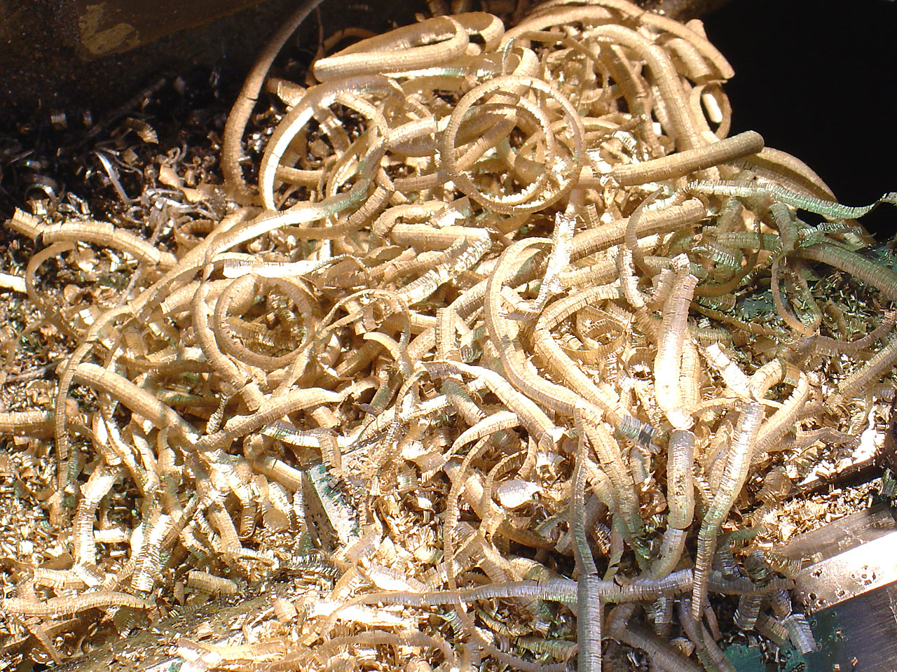

    Zoom particular brass shaving.
    Zoom The 8 columns are ready for chromium-plating.
    Zoom An assemly test.
    bye bye :thumb:
