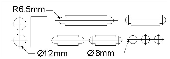

    I have made a Abit NF7 (ATX) render with mounting holes in as well as PCI and AGP slots. The holes are exact ;) and the PCI and AGP are EXTREMELY close :D .
    Can email someone the *.zip with the *.dwg in if someone wants (you can contact me by my ICQ in profile)?

    any chance you have that in CAD form?
