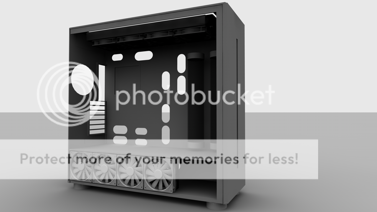

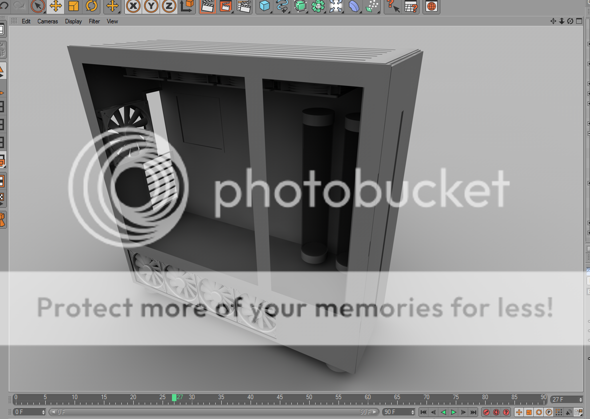

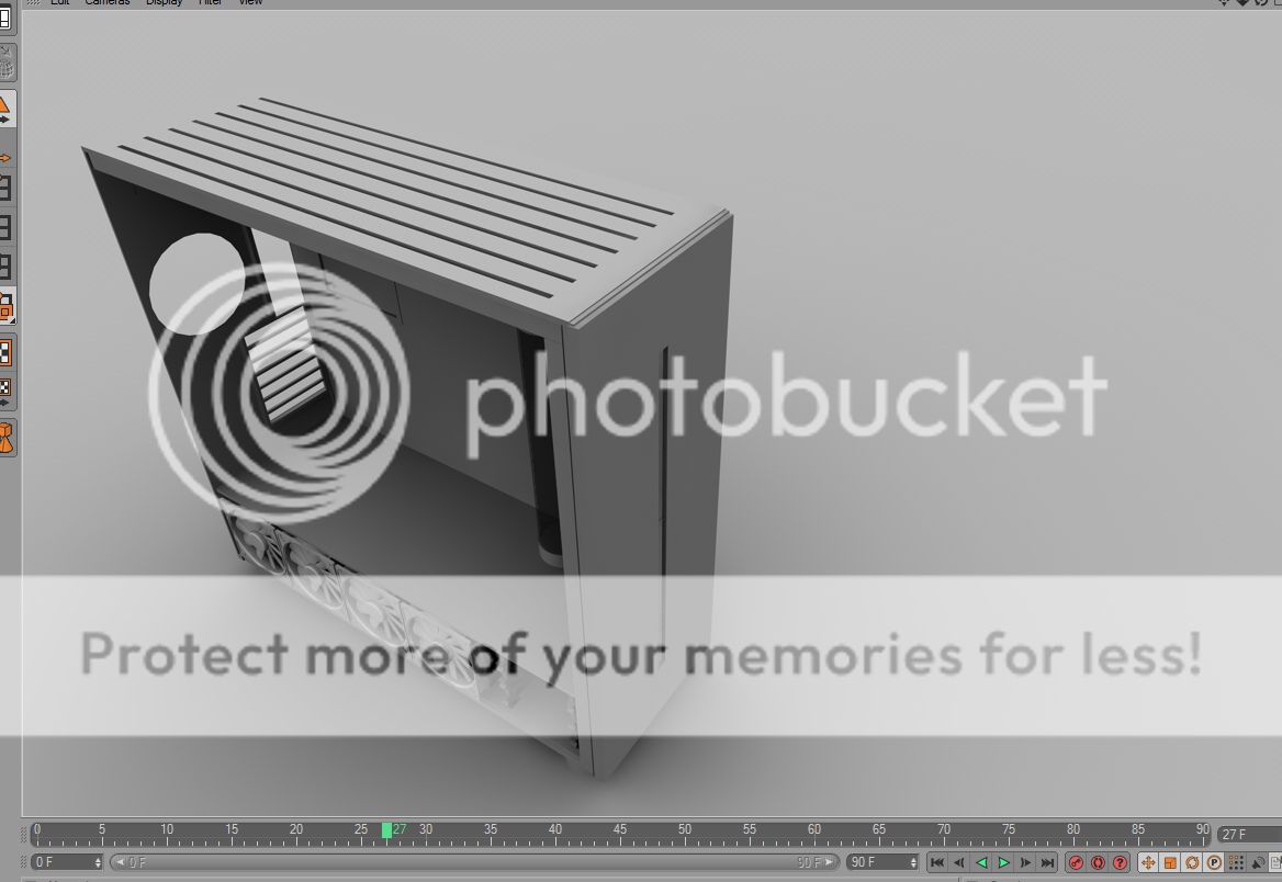

    Well here Is another little update. I added a side window as well as the bent plate at the bottom that will serve as the case feet. I still can't come up with a top door that Im happy with but ill get there.
