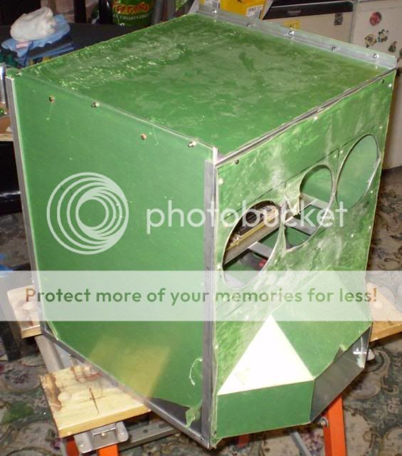

    Made the front & back panel to size.
    Realised I could not bend the 1.5mm panels well so had to re think the top & side panels.

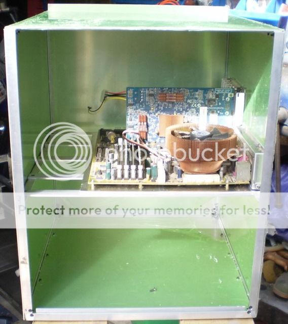

    Got the back pci back piece area cut out and aligned the tray with old motherboard and gpu installed to get perfect marking holes.
    Cut out a psu hole and added mounting holes.
    And here with a couple of stands for the psu.

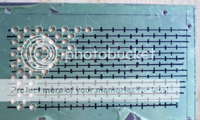

    Had a mess around with the drill press to see if I could have a go at making my own mesh.
    Marked out an area just above the pci slot area for attempting my mesh.

    I decided to do fancy grills for the front.
    Up to this point I had in mind to polish the entire case, but the cut outs were not perfect enough even after filing for me to go with a nice polished finish, so I guttedly cut them out :(.

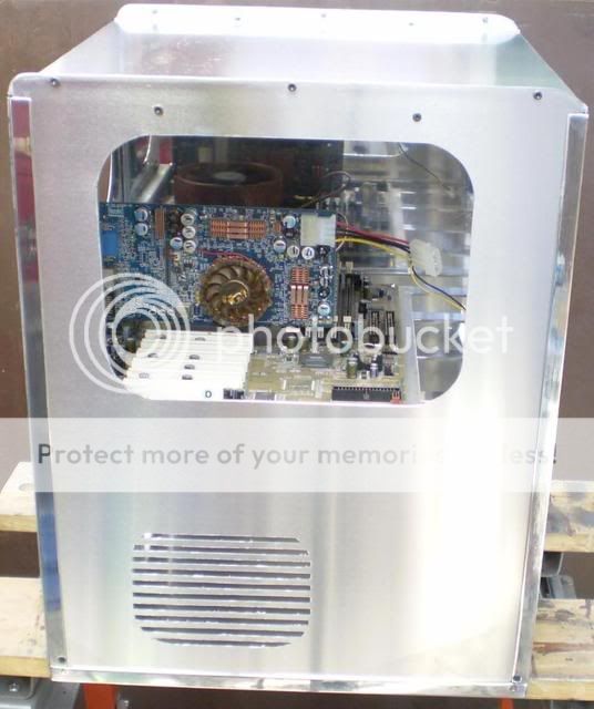

    I got around to making the sides and top to be 1 piece that lifts off for service, I added angle bars to clamp the sides to the top piece and side pieces, there is an angle bar which can be seen and 1 underneath to keep it rigid when it goes on and off.
    I then rounded the edges.
    Added a grill and window cut out.
    And started using an air rotary tool because I got sick of my dremel overheating :).
    I then started polishing the frame.
