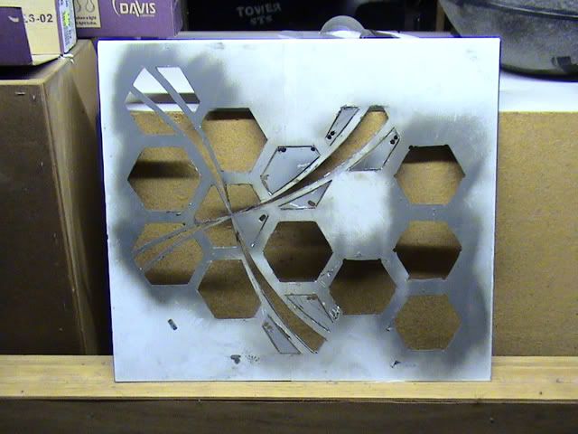

    I started cutting by drilling and using a jigsaw with plans on just filing the rest down but this did not go well. Its a real thick sidepanel so filing was going to take too long and as I got further thru the cutting the panel was not rigid enough to use the jigsaw so I gave up on that idea.
    I got myself a Dremel and went from there using the reinforced cutting discs. I went thru 6 or 7 of those to get thru only 1/5 of the cuts. I'll be ordering a few diamond cutting discs this week sometime so I can do the rest of the cuts.
    The cuts aren't perfect by anymeans but for a first time Dremel user I think I did pretty well. Hopefully it'll be a bit easier going with the Diamond bits.

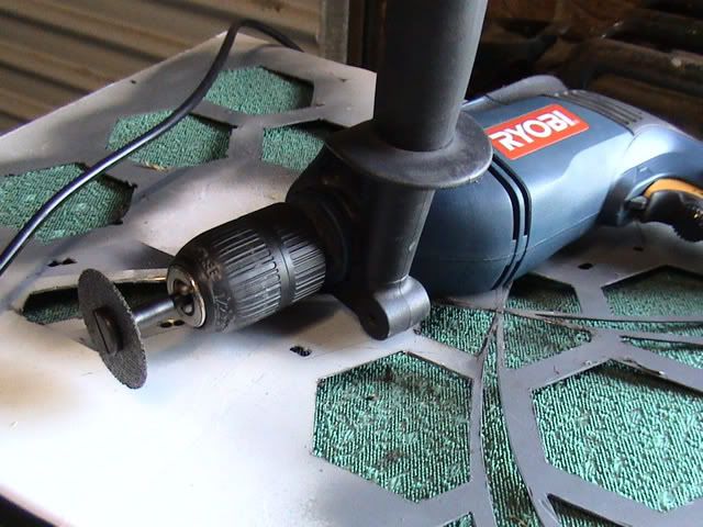

    The cutting is taking waaay longer than I expected. (Be warned if you plan on cutting a chenbro server case. The panels are made of structural steel :grr: ) I was going well with the diamond cutting bit and then I managed to break the head off the screw of all 3 of my cutting disc shaft thingys in quick succession :waah:
    No money till the end of the month to buy replacements (stupid electricity bill) so I'm borrowing a pretty gutsy replacement from my housemate until I can get more bits.
    This thing powered through the cutting as though the sidepanel was made of cardboard.
    Unfortunately I made a mess of the surface of the panel but its all going to be sanded back and powdercoated when im finished anyway.

    It doesn't matter too much this time, since you're gonna be sanding it back anyway.
    But those scratches a prime example of why you should always cut on/from the reverse side of the panel :idea:
    Great job so far anyway :clap: I look forward to future updates :thumb:

    @ hazardous
    Yeah I will definately be doing cuts on the reverse side in the future. Thanks for the feedback.
