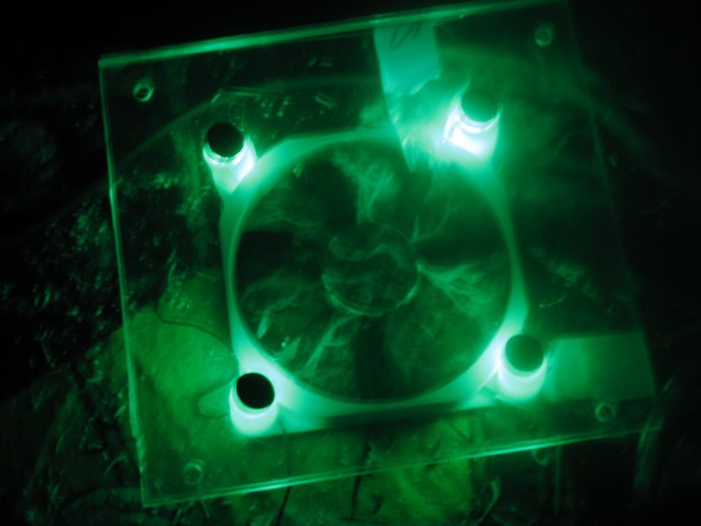

    This is what i'm doing with the front panel.
    120mm fan.
    2 - 40mm? fans
    Clear acrylic panels.
    Green leds
    More to come soon.....

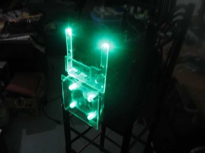

    I built a fan bus controller to control the speed of the front intake fans. The bus has 3 fan connectors, a pentameter, knob, and a single power connector.
    With the panels in place the fan bus will not be visible for the most part.

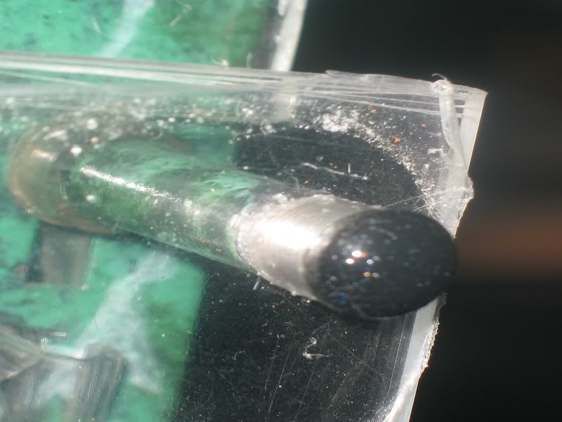

    The panels are coming along nicely. I got a nice coat of clear a few days ago. This is a flat black with an opal flake. I cant wait to get a couple more coats of clear on them.
    Out in the sun.
    After a few days in the sun I'll wet sand them, and respray.

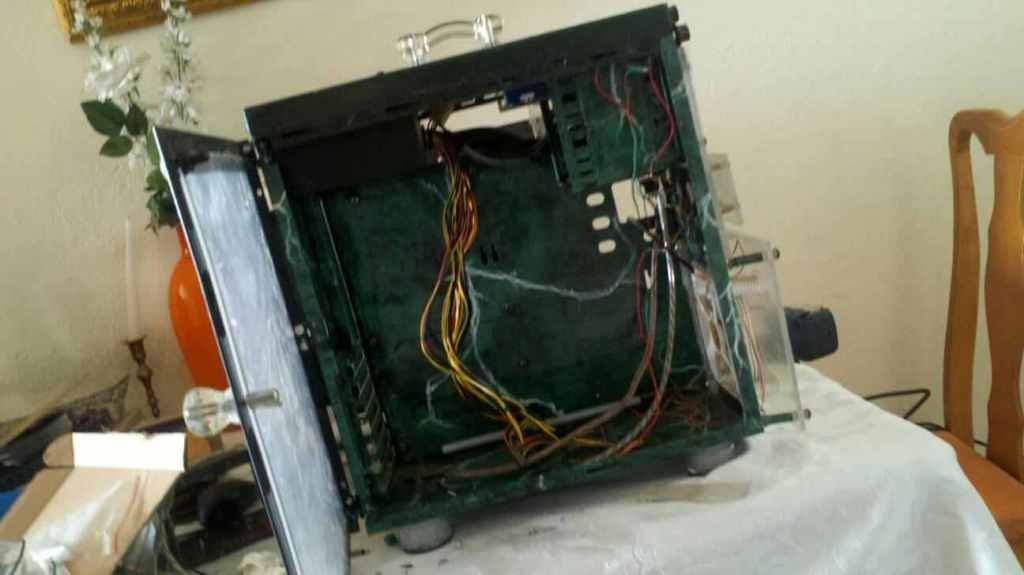

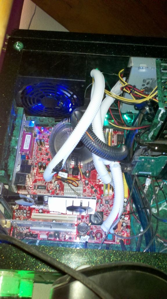

    So this rig sat up in my garage for the last two years but it has finally found its resurrection.
    Since the case itself is pretty much finished, my first goal was to get some hardware in and get the system up and running. Along with wiring in a few leds and the blue neon tube.
    Next I switched the fan in the psu. Probably gonna pull it back out and paint it when I get to resleaving the cables.
    I have started on a 100 percent custom liquid cooling system of this project. More to come soon. Thanks for looking.

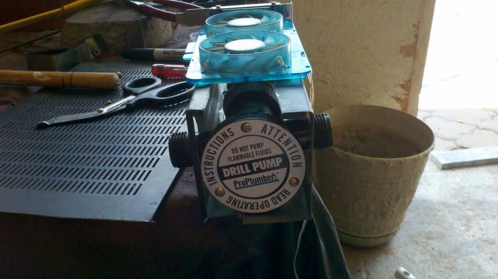

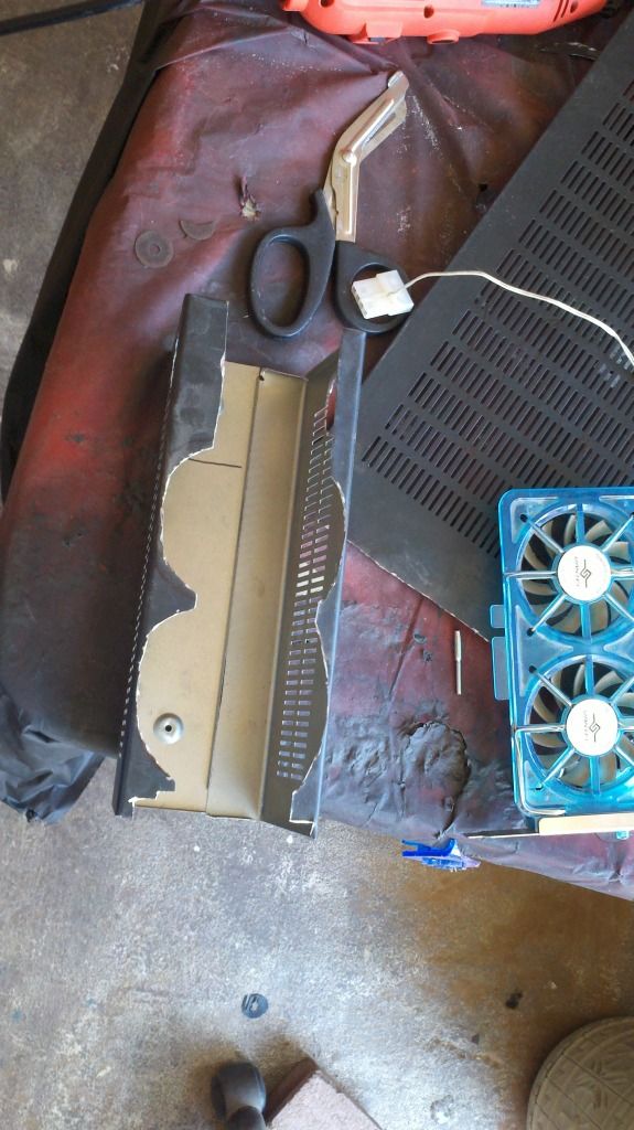

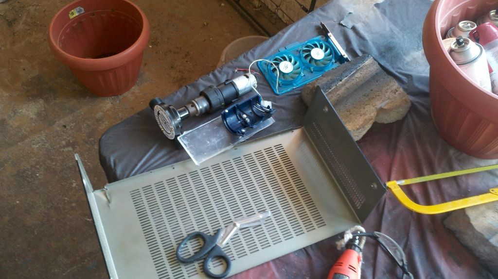

    A back shot

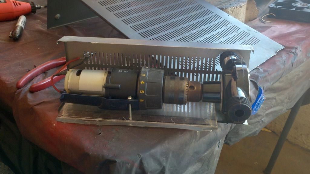

    The pump: an old drill that no long will take a charge and a $6 drill pump from lowest.
    Big compared to pumps sold for liquid cooling or even a fountain pump, and that the fan is over kil.
    But it will look good and its almost free.
    Hope this weekend I get some time to paint this thing, white inside black out. Plug the front and back with plexi and add a few green leds, and an on/off switch. Im going to wire it into an speed controller.
