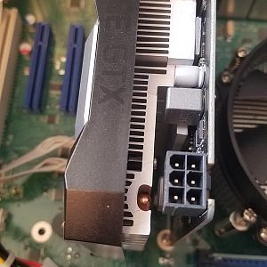

    I'm building some PC from leftover components for my kids.
    I'm upgrading from a 1050ti to a1650 super.
    For 1080 gaming, this should run well for a while.
    The problem: the 1050ti ran without additional power, the 1650 super needs an additional power plug.
    Not the usual 8 pin however, but a 6 pin one
    My PSU has an 8 pin connector, but not a 6+2 one, and it does not fit.
    It's also NOT called GPU, but it's called EPS
    So I bought an 8-pin to 6+2 pin adapter
    one side fits on the 8-pin plug, the 6 pin fits onto the graphics card
    However, the PC does not turn on.
    It only turns on when i remove the GPU power plug, so I guess it's either short circuited or the wrong pins are connected.
    - is the EPS plug pinned out differently from a 8 pin GPU-powerplug? (if so, why does it fit mechanically?)
    -or is my adapter cable pinned out wrong?
    Best regards,
    Xir

    It very much is, yes. EPS:
    PCIe 8pin:
    Lack of aforethought?
    I believe the locking tab on an EPS plug is thinner than the one on a PCIe 8-pin plug, but they're close enough. Especially if you buy adapter cables which sit between the thing and t'other thing.

  5. Xir
    Xir Modder
    26 Apr 2006
    5,412
    133
    Quite the opposite, they're bloody expensive Bicker BEA-640 industrial, 24/7 guaranteed PSU's. :grin:
    No it fits perfectly in a 8 pin GPU as well, the "squares" and "rounded squares" pattern is exactly the same. :rollingeyes:
    Ah well, I'll replace them with some BeQuiets...can't be bothered to change the Pinout manually.
  6. noizdaemon666
    noizdaemon666 I'm Od, Therefore I Pwn
    15 Jun 2010
    6,193
    893
    They shouldn't be. Unfortunately though, all the rounded pins will fit in the square holes, and all the square pins line up with square holes meaning that even though they're keyed completely differently, an EPS12V connector will fit nicely into a GPU 8 pin connector :doh:
