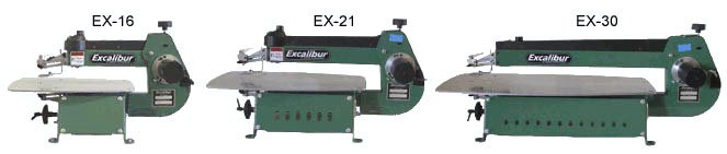

    Excalibur also makes excellent scroll saws, the EX-16, EX-21 and EX-30:
    which Axminster also sells as a rebadged version. They come in three sizes: AT406SS, AT533SS or AT762SS (Excalibur EX-16, EX-21 and EX-30):
    Manual here: 101771_101773_manual.pdf (axminstertools.com)
    You probably want the smallest one; they are solid, BIG tools --the smallest the size of a sewing machine-- (I own the AT762SS, which I picked up second hand on eBay, and it is HUGE). The largest is not made anymore but can still occasionally be found second-hand on eBay. They are not cheap, so again I'd go to eBay first --Excaliburs are still widely in circulation.
