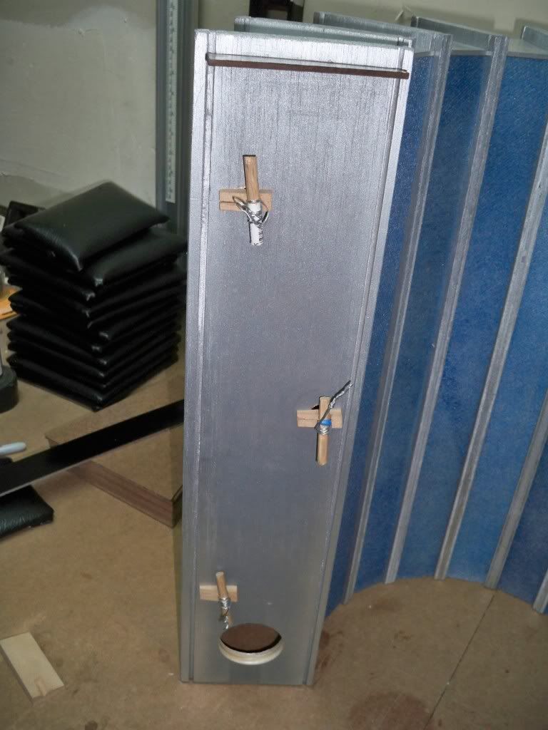

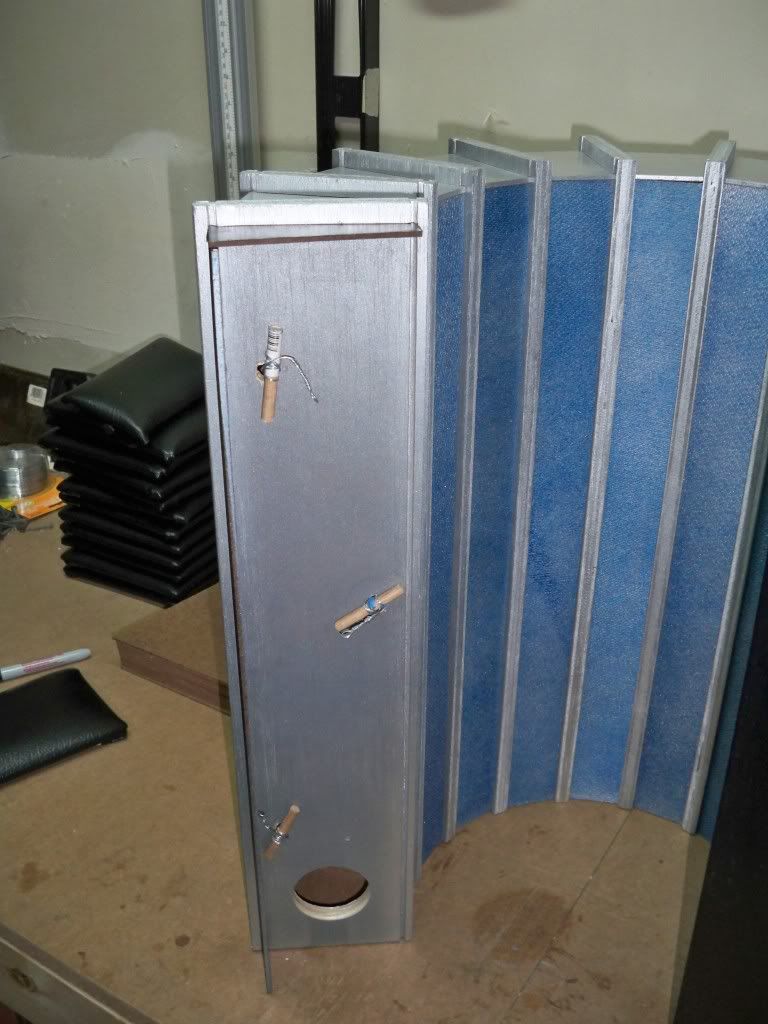

    Here are some photos of the wire supports on the inside.
    This is a shot of the last vertical fin. There are one 3/8" holes for the wires and one 2" hole in the bottom for future items (air flow, water cooler, etc)
    This is without the wedges. They provide additional tension on the wires
    Here is a shot of the wedges.
    This is the shot of the bottom with the cable supports in place.
    Here is a closeup.

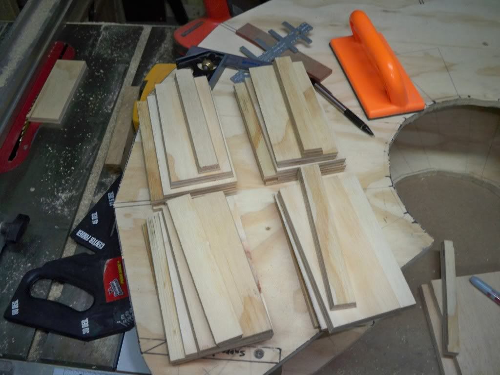

    As for the seats and fronts here they are all tacked up.
    This is what the started out as.
    And here they are spread out across the case. They are the fronts, not the seats. Those still need to be made.
    Next task is the remake of the base and cutting the keyhole slots for the mounting screws for the front faces.

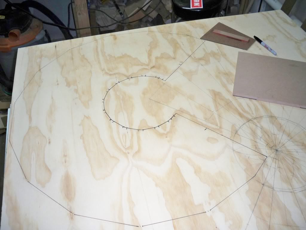

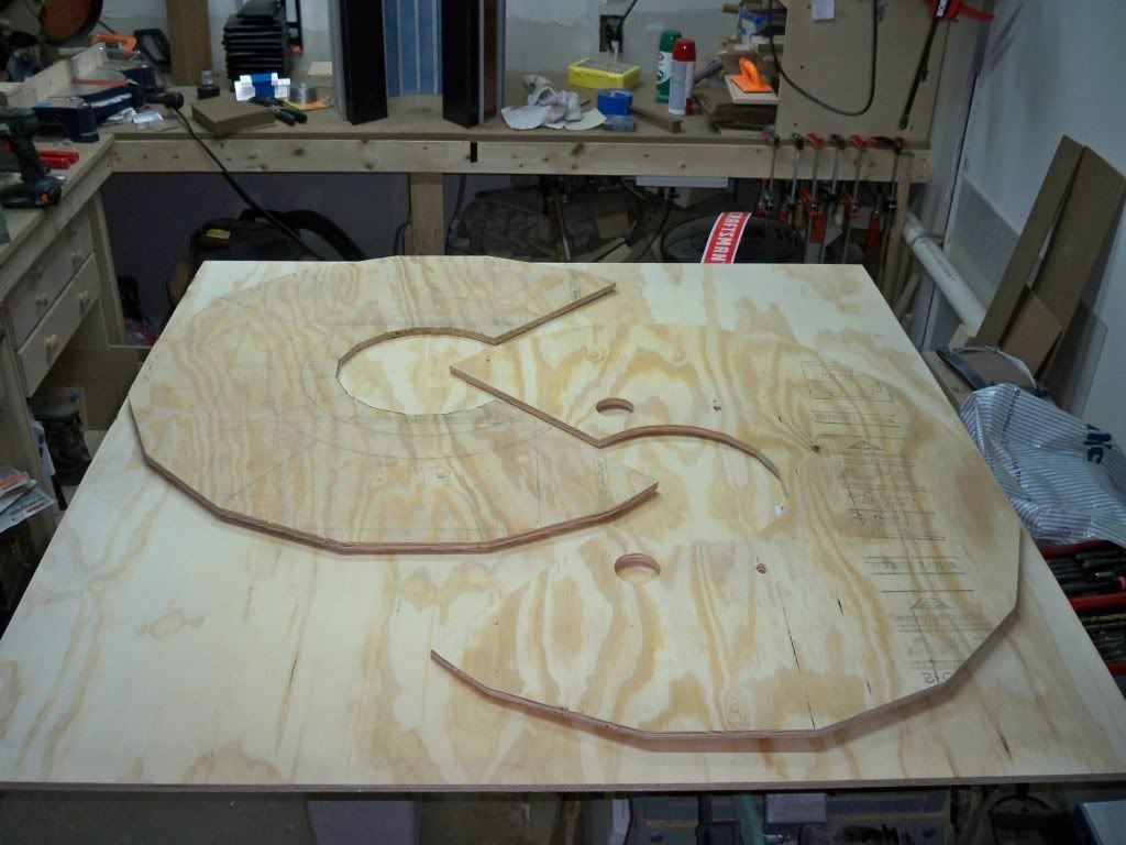

    Well, it was not easy but my case finally saw the error of its ways. Accuracy is much more important than time.
    Here are the two defeated halves.
    The both fit on the 4x4 plywood. Just an inch between them.
    Here is the outline for one half.
    On the right, was the layout with just a compass and a straight edge. Had to find the mid point for each line in order to get to 11.25' and then 5.625' for the correct angles. High school geometry at its finest.

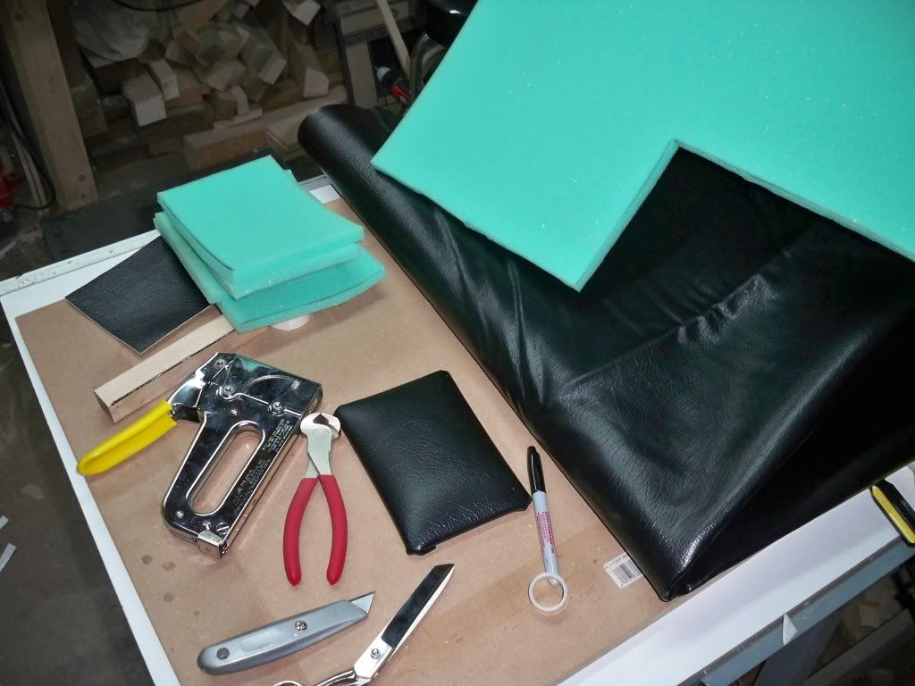

    Here are the two halves cut and sanded together.
    Here is the layout again. You can see the 3 vertical supports and I moved the orientation of the hard drives. Not sure if I like them vertical like that. May put them back to horizontal.

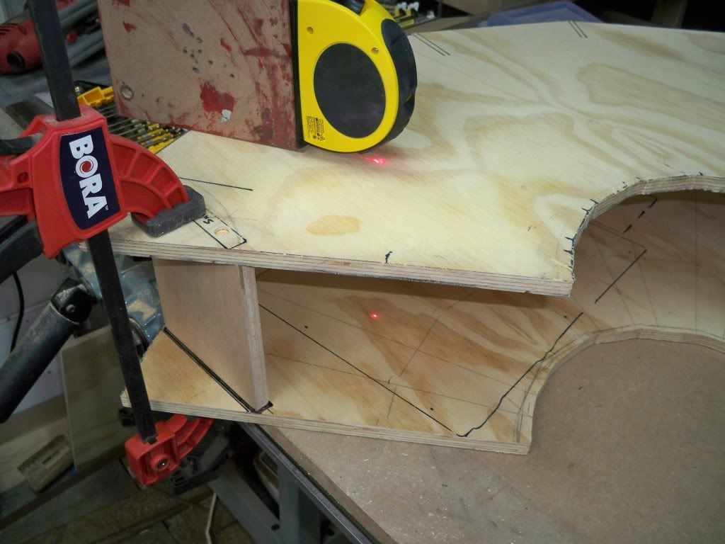

    It was time to assemble the two halves again.
    So I used my trusty laser level to align both parts exactly.
    I used the holes from the screws when I was sanding the edges smooth and flat.
    Here is the center hole.
    Enjoy.

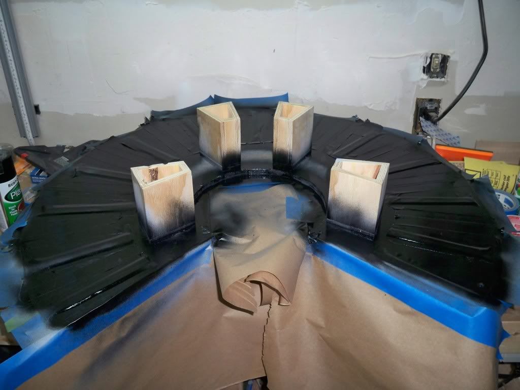

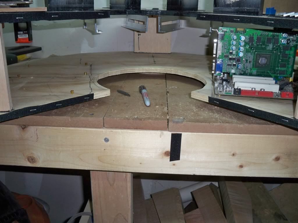

    Started working on some supports for the tower.
    Took some of the left over ply wood from the two havles and made them
    Here they are cut.
    Here they are mounted on the top deck, and the deck painted.
    Next up the seat covers...

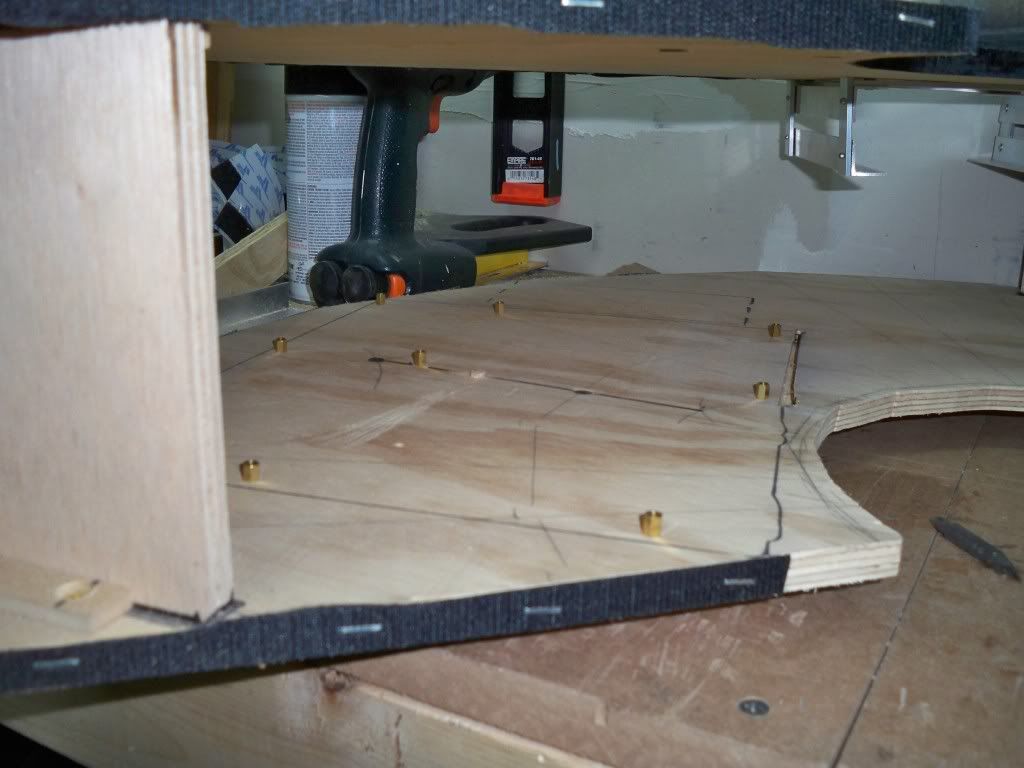

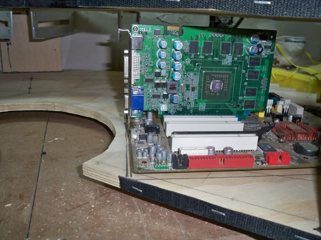

    I also put in the Mobo offsets. Drilled a 7/64" hole and then used my cordless drill to insert them.
    I also had to put in a rabbet for the extensions of the cards. It was 1/8" wide and 3/16" deep.
    the cards now fit perfectly.
    I also gave the case some feet. Three 3" radius circles. Cut them on the bandsaw.
    Enjoy!
  20. Volund
    Volund Am I supposed to care?
    16 Sep 2008
    1,947
    65
    Awesome build so far, only thing I would add would be metal tubes (alu or copper) to the holes your wires are running through to hold the tower together. It looks like the wood is already indenting due to the pressure that the wire is exerting on it, and it would save you tightening the wires in the future.
