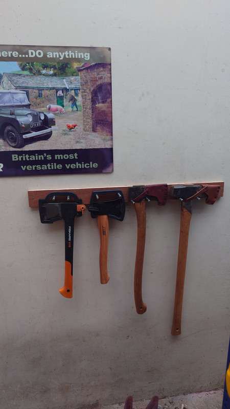

    Today I knocked together an axe rack from scrap, it's been annoying me just having them lean against the wall. It's a shame that Fiskars faces the wrong way :hehe:
