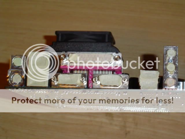

    Next, cover all the I/O plugs on the 'outside' of the motherboard. These include the parallel ports, serial ports, PS/2 ports, USb ports, ethernet jacks, and audio plugs. Put a piece of tape over them and cut the excess away from around them, similar to what you did to the IDE, floppy, and power plugs.

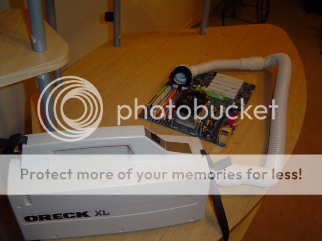

    Last step, for the motherboard. To make sure that there is as little 'stuff' on your motherboard as possile, use a soft brush attachment on your vacuum to get rid of any crap. Alternatively, you could use a cloth or paintbrush.

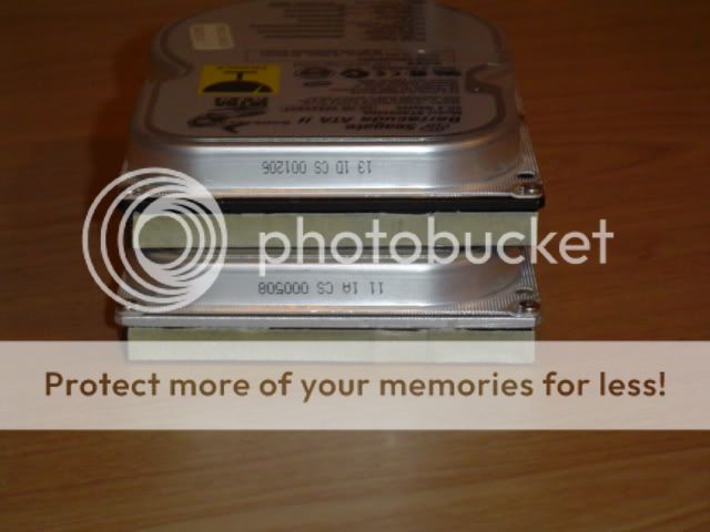

    Time to cover the logical devices, which include hard drives, CD-ROMs, and floppy drives. For these, just cover the connectors, jumpers, and the molex plug on the back. If you need it, cover the audio plugs on the CD-ROM.

    Would the vaccum brush not create ESD???

    Yes, Im very Suprised people still use this meathod of cleaning computers, alot of people say that its fine and never killed my components -ive seen people that have and killed pcs, and if they dont kill it, it will get progressivly worse -about 6months from now all his kit will be dead.

    The vacuums have never had any problems with me :worried:

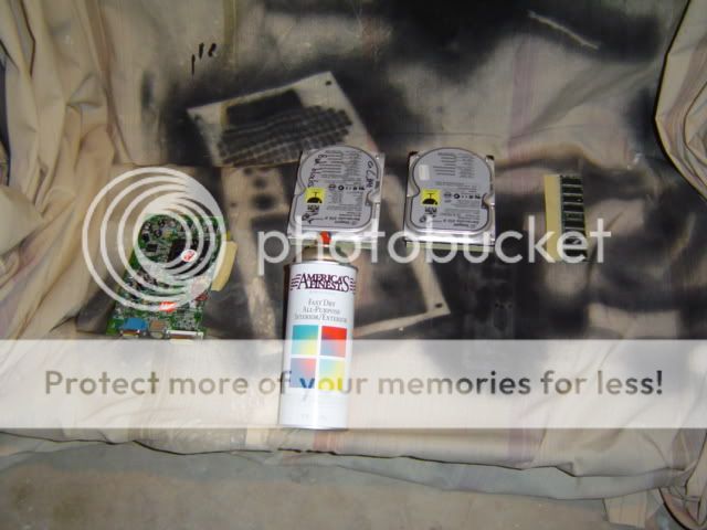

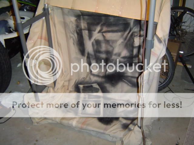

    Find a good place to paint your parts. Try to have a well ventilated and well lit location that is out of reach from grabby hands. I used a sheet, a light, and a clothes hanger for mine.
    Set up your parts so that you do not have to move them that much. The more you have to handle them, the greater chance there is that something is going to go wrong. Everything should be taped off that needs to be.
    From here on, everything is design and personal preference. You are probably going to want to go with a 2 color scheme for some contrast, but you do not have to. My scheme is a base color of green with white accents. This means that the motherboard is green, fans are wihte, cards are green, and RAM is green. You can design however you want to.

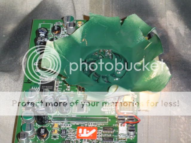

    To paint a fan without removing it, just mask off the area around it and spray it. The bearings will not get touched, and you still get a nice coat with minimal effort.
    Mask off one side of your hard drive so that it does not collect overspray. This is similar to masking the area around the fan.
    Paint the hard drive using light coats. You can use as many or as little as you need for an even coat.

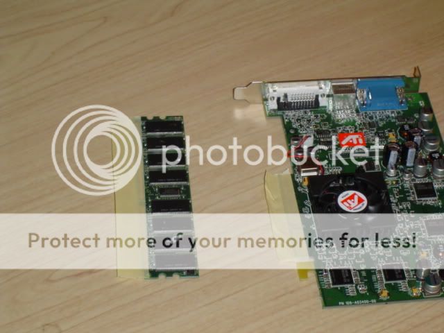

    This is the RAM, prepared and ready to be painted in a different color. You are going to have to paint one side and wait for it to dry before you can turn it over and do the other. Or, you can hang it from something to get both sides.
    The (half-)finished RAM module.

    I hope the fan of your graphicscard still works after painting, most of the painting mods of fans removed that part before painting. [​IMG]

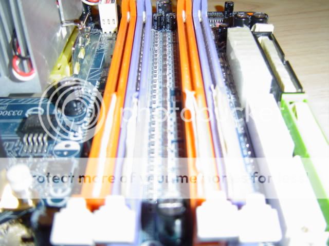

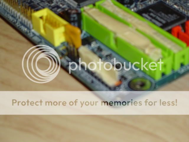

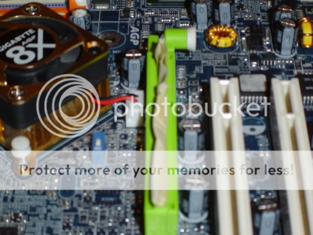

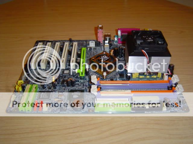

    I found the old machine, and took a few pictures for you naysayers. By the way, these pictures are hosted off of my website, not Photobucket, so tell me if they don't work.
    Here is the system, in all its naked glory. There are no expansion cards because I wanted you to be able to see the slots.
    This shows off the RAM and IDE ports pretty well. On this one, I just taped straight over the top instead of covering the pins. That gave them the ugly effect you see here.
    I did the same thing with the AGP, PCI, and other ports. Notice how they do not match at all...
    Overview shot of the whole system. Notice how, if you do the IDE / floppy ports the way I did, paint comes in through the gaps.

    I applied the paint kind of heavy to this one, so those rings with wire around them get pretty hot (anyone know what they are called?). Eventually, the hot parts just melt / burn away the paint that is blocking them, so a 24-hour burn-in is helpful.

    Toroidal Coil ?
