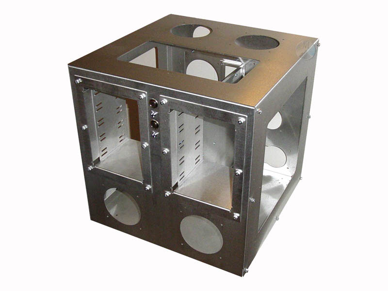

    Hello Im new to this forum but I joined mainly from the amazement of Dark Blade by G69T and well it inspired me to start a mod granted it wont be nearly as impressive as his and ad to the fact that Im new to this world but I will give it a shot. ^^
    I have been thinking of building my own case and a new system, well after thinking, designing, drawing, and budgeting I have decided to get started.
    Now after I got done with all my designed and budget the case cost I found that it would cost me around $400.00us, my case design is very similar to Mountain Mods U2-UFO Optimax, so similar that I decided to contact them and see what a case similar to my design would cost me and it ended up factoring out to be the same so I placed an order. ^^
    The main changes to the U2-UFO Optimax that will take place is that the motherboard will be on the right side of the case in what is called upside-down or reverse ATX standard where the cpu is towards the bottom of the case, the psu will be located at the bottom of the case as well on that side of the system however will be mounted on the top left side of the case instead.
    The only thing that will be on the right side of the case will be the motherboard, the 3 DD D-5 Pumps, 3 custom built res, and the 2 fan controller and lcd readout screen, everything else related to the computer will be mounted on the left side of the case.
    This Project thread will be the construction and modification of the case itself and the water cooling system that will be installed, as far as the computer parts that will be installed will come at a much later time after Vista comes out.
    I plan on running three water cooling systems in this case, one for the two graphics cards and one for the CPU and one for the North-bridge, HDDs and ram. On the graphics cards I plan to run EK Full coverage blocks and for the cpu and north-bridge I am still researching what block I will get once I decide on which AMD cpu I will go with.
    Here is a picture of what the case looks like when I got it.
    Product Link: http://www.mountainmods.com/product_info.php?cPath=21_60&products_id=82

    The back of the case will be cut off and rotated to create the reverse ATX affect.
    Here is a fast not accurate in dimensions just as reference design of the back of the case.
    Alright well here are some pictures on after I cut the back panel off and then after I used the JBWeld, once that cures (15hrs) I will apply a second coat to the inside of the case and where the clamps were located and then after complete cure will sand it smooth.
    [​IMG][​IMG]
    [​IMG][​IMG]
    Here is the video of me cutting the case, you have been warned lol
    http://video.google.com/googleplayer.swf?docId=-7636707949965641236&hl=en
    Here is the bottom and the inside after the jbweld
    when I was setting the top, I cracked one of the corners, which lol happen to be the corner that I knew would be weak but afrer I sand that down and reapply thinner coats of jbweld it should hold like the rest.
    Here is a before and after shot ^^
    Before:
    After: (the motherboard tray is just sitting there not mounted)

    thanks guys the weather has been horrid so its slowed down my progress on the case Im waiting for a break in the weather to get some more paint work done and Ive ordered a few more parts that will get mod to fit the theme of the case.
    This a quick to do list I did just to help keep track of some of the things still left to do.
    To Do List:
    1) Finish remaining prep work on case
    2) Finish Paint
    3) Rad Cross and Front Fan Cross cut out
    4) Corner pieces cut out
    5) Paint cut out pieces
    6) Order Gothic Hardware for case
    7) Paint Gothic Hardware to mate cut out pieces
    8) Get all the acrylic work etched
    9) Cut out acrylic accent pieces
    10) Assemble Accent parts, cut out parts and gothic parts, acrylic etchings to case.
    11) Purchase Aquaerro stuff before the end of the year
    12) Finish working on Secret Project with Robo
    13) Purchase sound dampening foam
    14) Purchase all the lighting parts for the case
    15) Install Sound Dampening foam
    16) Install lighting
    17) Work on any other accents, covers and so on that will bring the theme together such as optical drive covers, ect...
    18) Move onto Part Two of the build.
    expect this list to get bigger instead of smaller lol
